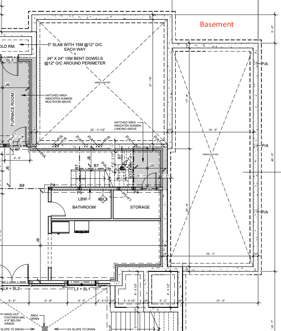

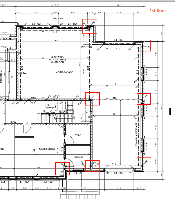

Hi there,
I saw it a couple of residential houses design drawings. The designer used steel beams (like W10x45, W12x50, even W14x90) for the second floor load and one end of beam was supported by steel column (HSS 4"x4"x1/4"). However, the column was placed at the exterior foundation wall. I am roughly guessing the load on column might be 20,000 lbs or higher. The foundation wall was 10" thick and the footing was 16"wide and 8" deep. And there was no extra reinforcement in the foundation wall. My question is that is it safe to design like this? I am in Toronto, the house I saw is a two floor residential building with a nine foot height basement. I don't see that often so I think it is bold to do so. Or maybe my experience is not sufficient enough coz I am into residential design for a year. If this is safe, it will be very helpful to do many designs with aesthetic interior.

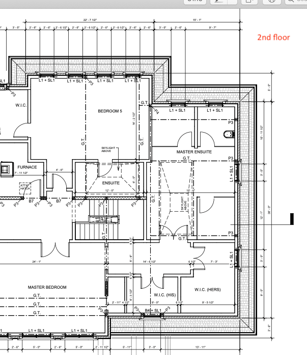

1. To allow you all see clearer the design, I attached one section of the structural drawing from basement to second floor. P6:HSS 4"x4"x1/4" column, B17 = W10 X 45, B18 =W10 X 54, B19 =W12 X 50, B20 = W12 X 58, B21 = W14 X 90, B22 = W14 X 76,
2. Also a correction, the footing is 26" wide x 8" deep, not 16" as I mentioned in the first place. The concrete used for footing and foundation wall is 20 MPa.
3. The steel post on foundation wall are mostly in the un excavated footing/foundation walls, but there are two posts sitting on foundation walls that one side is soil and the other side is basement.
@XR250, not sure what is the degree of angel the designer used.
@phamENG, I get the 20kips by rough estimating the load above, including the load of one section wall from the second floor (second floor has smaller footprint and the exterior walls are on these steel beams), the roof load, tributary area. Of course, my estimation may be wrong coz I didn't detailed the calculations.
@LittleInch, more information is added. And I also think it may be better idea to increase the size of foundation wall where the column sits, but the design doesn't have that.
@JAE, I get your point that point load my crash/crack the concrete on top of foundation wall, so I did a rough calculation, for a 6" plate at the bottom of steel column, the concrete contact surface can stand over 100kips of load for a 20MPa (2900psi) concrete. So that shouldn't be an issue. And your concern is mine as well, if the footing doesn't bend, high concentrated load would occur, so it seems wiser to increase the thickness of foundation wall where the steel column sits, forming a pilaster shape concrete column to support the steel post.
@jayrod12, The steel post sits right on top of the foundation wall, not the footing.
From those clippings, it appears the posts sit on top of your foundation wall? If so, the wall will spread the load out quite significantly as indicated by other posters above.
