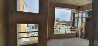

Hi
please find the attached files. This is an existing house. The owner wants to make some renovations. Before in the links denote to before renovation, while after denotes to after renovation. I proposed the W or I section displayed in green in the attachments to be placed under the the lower and upper slabs. The house is a two story load bearing masonry wall, and RC slabs. Does my proposed solution make sense? Are there any considerations one should be aware of? Are there any other solutions available? The slab beyond the proposed steel sections are 1.8m. Are there any solutions to account for these slabs?

These images are before renovation

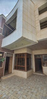

These images would be after renovation
