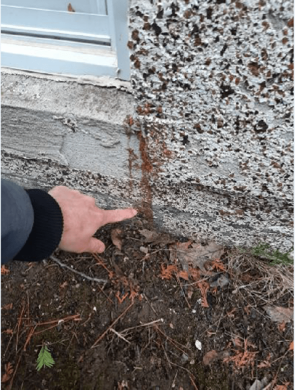

I am shopping for a single-family home. There is a house about 50 years old that interests me. However, it has a 5mm wide crack at the front and back. The crack may go from one side of the foundation to the other, but it is not possible to verify this without removing the floor, drywall, and insulation. The crack has spread on the exterior brick siding about 2 feet high, both at the front and back of the house. However, the crack has not spread to the interior drywall.
- What does this type of defect imply?
- Would it be relevant to request a quote to see if it would be appropriate to consult with an expert about underpinning the foundation and injecting the cracks? If so, is underpinning + crack injection a durable solution, or is it a temporary fix ("band-aid")?
- Could the fact that a house has been underpinned and injected scare off buyers? I am thinking about resale value in the future.
Sketch:
Photo of the crack at the front:
One photo from a potato isn't going to be useful even in the slightest. It could be a failing foundation or nothing or someplace in between.
If you feel there is a structural concern you have to hire an structural engineer.
A potential buyer of a home sent me a few photos from a home inspection report last week, looking just like this. The photos showed a crack in the two blocks above a crawlspace vent opening. The buyer said what do you think? I said it looks like they took a block out to make the crawlspace vent and the block above cracked, not uncommon, they never put a lintel or any reinforcement over those things. They were in a rush to close and didn't really want to spend the money to have me go out there. I said listen I have to be in that town for another visit the next day, I'll give you a little discount, not really much I can do looking at two text message photos of screenshots of the inspection report. They said fine.
I walk around the side of the house and guess what, it wasn't just a crack over the vent opening. The entire left side of the foundation was broken and failing. The crack over the vent just so happened to be in the area where the foundation was falling into the lagoon. The buyer didn't know that. The home inspector didn't know that, but that type of failure I see weekly around here. I called him right up and said this was the best money you ever spent because you're going to need helical pile underpinning all around the left side. They took my report, got a quote for the repair, and got that money off on the house. Needless to say they were very happy spending a few hundred for my time and saving tens of thousands on that house.
Get an engineer.
Retain a licensed engineer to help navigate the issue, or have the homeowner retain one.
There is no way to know the extent or cause from what little you’ve shared, so any conversation about underpinning is premature and potentially irrelevant.

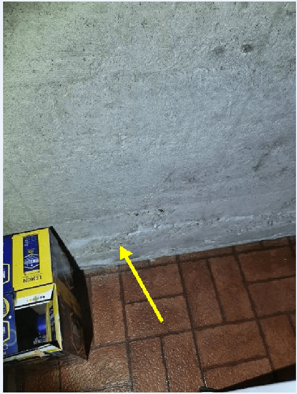

Here is an image of the concrete foundation, but from the inside. Note there is efflorescence.

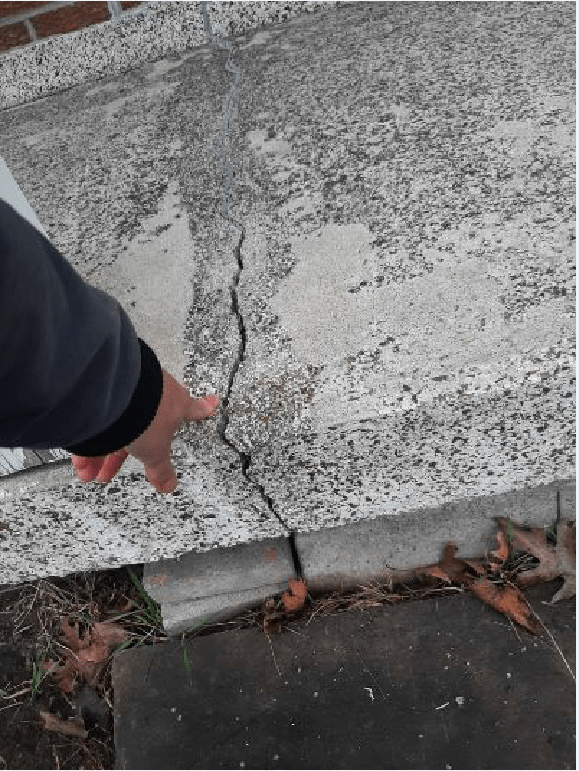

Here is a photo of the concrete balcony at the front of the house. The balcony is just on top of the crack I have shown in my first post. The cracked propagated through it.

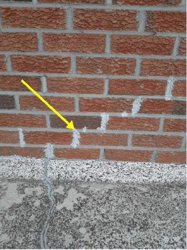

But the crack didn't stop there, it went through the brick.
Here is the crack on the other side of the house (at the back of the house). The crack was repaired 10 years ago, but the buyer gave me no bill (so I have no warranty).
Efflorescence is generally a moisture related issue; what is the groundwater table like?
Hire an engineer if you are sincerely interested in this.
Answers given here, by good engineers mind you, could be very wrong as they are based on a few photos.
How can I get information on the groundwater table? I would say that the groundwater table was fairly high before the construction in this neighborhood, judging by how the forest land looks like not so far away. But I feel that the residential development drained the land quite a bit. There is a small river at about 500 m from this house. The basement floor is about 10 meters higher than the top of the water in the river in normal condition according to Google Earth.
The ground in the region has a lot of clay in it.

Even with those additional photos, it's just hard to get any idea of what's going on. Could be some shrinkage cracks, some minor settlement, or something more serious.
The only thing that I can tell you for certain is that this was previously patched and those cracks have opened back up, which would seem to indicate continuing movement.

Concrete appears to be deteriorating based on the colors and texture. If allowed I would check to see if it flakes off or breaks easily. I have found some houses were built with poor quality concrete that you can pull bits off by hand and with a hammer easily break chunks out of. Look at the old aerial photos see what the are looked like before the house was built, was there a wet land or a low spot where they might have paced fill. Differential settlement could be the cause or lack of reinforcement. I looked at a foundation for a town because a home had over a hundred cracks in the foundation without even having a building on it yet. On Instagram the builder had posted videos of their work and in that case they built on topsoil, stripped the walls too fast and likely had too much water in the mix. On top of all that the engineer had provided a design that did not meet code and failed to specify construction joints. Do your homework and ask questions. Foundation issues are hard to fix and expensive.
Vertical cracks are usually a result of differential settlement (i.e. one side of the crack settled more than the other, foundation cracked to accommodate). The question is, has the settlement stopped? That's not for me to say, but you could contact a geotechnical engineer and ask them what it would cost to look at it and to provide recommendations to stabilize the soil if necessary.
Horizontal cracks are bad news. They imply that the wall isn't capable of withstanding the pressure from the soil bearing inward.
