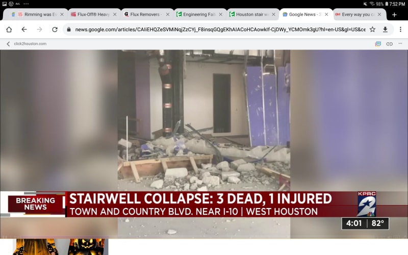

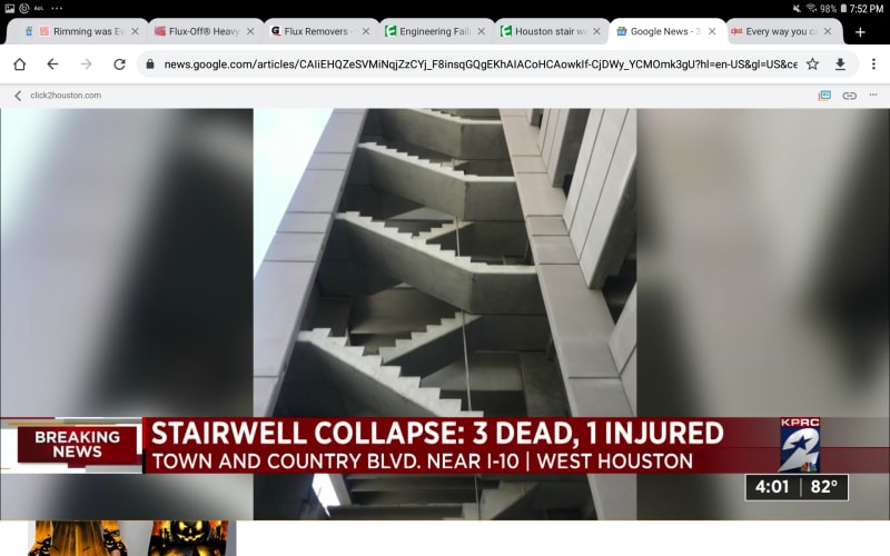

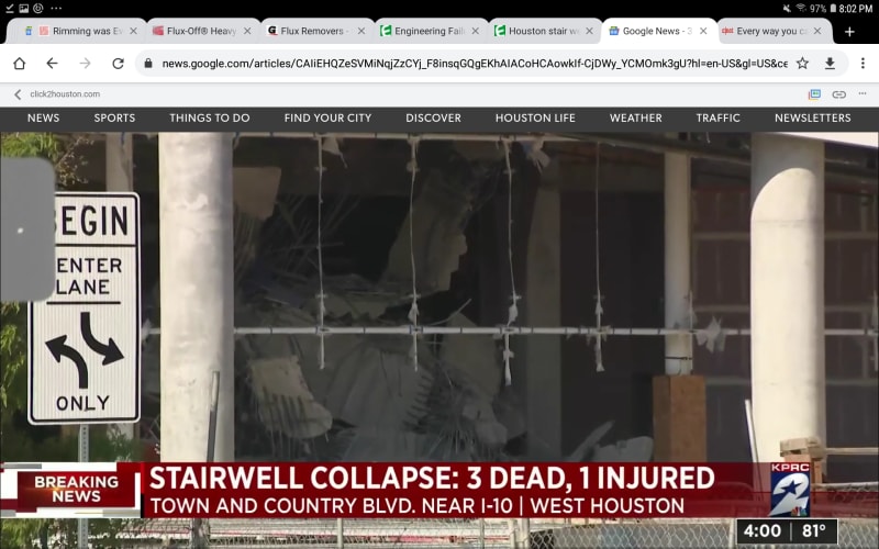

Anyone have any additional info on this?
Link
Better footage at this link
Link
Any chance they were precast stairs being installed as the building went up, and the upper one wasn't secured and fell bringing the ones below it down as it continued its path downward.

Damn precast. Again.
I've done a lot of buildings with precast stairs...not recently, but used to be quite common... both site and plant... economical and excellent finish. If done correctly there is no issue.
Quoting "... If done correctly..." Seems like famous last words. Better, this activity has high adverse consequences when not done correctly.
I've seen some people only reinforcement precast stairs with a single layer of reinforcement at top or bottom to suit the final configuration and moment diagram. Effectively ignoring the fact that in lifting it into place the moments are often -ve moments, vs positive in the final configuration. having some bars at minimum cover in the bottom don't work too well bending the other way... When I pick it up in reviews, sometimes I get the precaster is responsible for the lifting design. Sometimes precaster does not have this expertise.
I see it as a safety in design issue. I always have two layers in my precast stairs to avoid any possibility of any issues with lifting.

The failures are sufficiently rare that most engineers won't see one in their lifetime. That doesn't mean precast structures aren't overrepresented when it comes to accidents and failures.
This is the first failure I have heard of that may be precast stairs. Is that definite? Precasting of stairs is a new one on me.
I agree with the adverse sentiment about precast in general, particulary for parking decks. It seems we hear about a couple of those every year...from failure to tie the bits together adequately. That brings to mind the one at Emory University in Atlanta, which was reported here in September. Best to report it in that thread, but any more news?
