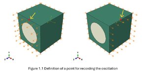

I am investigating the vibration properties of unidirectional composite materials using ABAQUS. My aim is to compare the damping behavior in both the longitudinal and transverse directions. However, my current results show unrealistic behavior: the oscillations decrease at first and then start increasing, which is non-physical.
I suspect that the issue lies in the setup of the boundary conditions, or step definition. The model was subjected to a 1% strain along its length, then released abruptly to observe free vibration.
What I aim to achieve:
1. Faster amplitude decay when damping is added.
2. Higher frequency and smaller amplitude in the longitudinal direction(parallel to the fiber).
3. Lower frequency and larger amplitude in the transverse direction.
The figures below describe the steps I followed in setting up the simulation. Any suggestions to resolve this issue?
Thank you in advance for your help.

Which type of damping did you choose - how did you define it in Abaqus ?
I applied structural damping, but even after removing it from the material properties, the frequencies remained unchanged.

Modeling at the fiber level helps us understand the material's behavior more accurately, especially when microscale interactions affect the overall response. But even when I simplify the model to a cube of one material (e.g., epoxy), the oscillations are still not correct. Do you have any suggestions to resolve this?

a guess is that increase in response is due to some sort of resonance.
or perhaps, since your output pt is on the matrix, that the fiber and matrix respond in different frequencies, leading to a complex displacement pattern.
have you run a simple static analysis of this model and review the displacements?
suggest outputting displacements vs time at different locations on your unit cell model.

You are using a dynamic implicit step. Structural damping is available only in frequency domain procedures. Try using Rayleigh damping.
