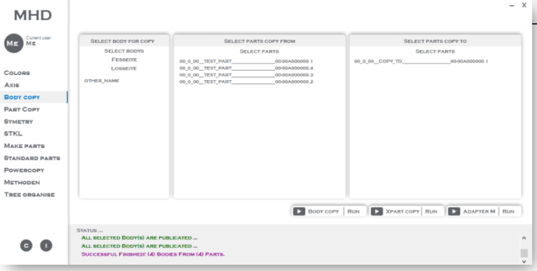

It's CATIA macro APP with a lot of integrated macros inside. You can't do anything without it (BMW standard).
Here is my App, it's like 5% of it.
