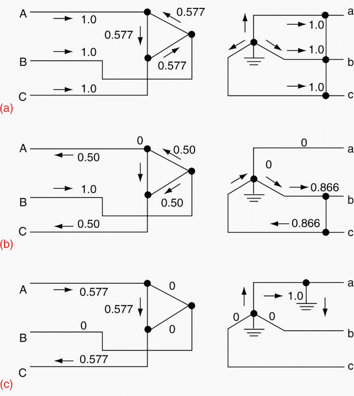

the more important thing you might have overlooked is shifting fuse curve for delta wye transformer specifically
a SLG fault on the wye side will result in 0.57pu current flowing in the delta side. this effectively reduces the current as seen by the primary side fuse if you want to coordinate between primary and secondary side protection devices.
Similarly a LL fault on the wye side result in effectively more current on primary side, so the primary side fuse is sped up for coordination purpose.
I'm confused, don't you mean slowed down for a L-G fault since the fuse is seeing less current according to your graphic?

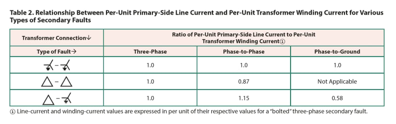

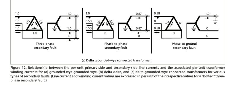

Thanks, I've been looking at that. Few questions come to me-
1) Why does table 2 list a per unit value of 1.15 for a phase-phase fault on a delta-wye trafo while Figure 12 lists 1.0, 5.0, 5.0 respectively? Where does 1.15 come from?
2) For a phase to phase fault the primary fuse subjected to 1.0pu will blow first, but what happens after operation with both 0.5pu fuses still remaining unblown? Wouldn't the fault still persist continuing to heat windings internally? Not sure how to take this scenario into account.
1)
phase to phase:. primary sees 1.15 more than secondary. This is the same as 1: 0.87 as shown in figure 12.
1.15 comes from 1:0.87
2)
good question
the 1.0 pu fuse opens and that's all. when this fuse opens, the two phases involved in the LL fault on the wye side will actually becomes same voltage and phase angle, although the short circuit still exist, since there is no difference in voltage to drive a fault. nothing trips anymore.
You can observe this for any delta wye transformer. Just open one phase on the delta draw the vectors, you will see all three windings are still energized, but only one winding get normal voltage, while the other two gets half voltage but and phase with each other.
1) OH! Any idea about the physics behind this?
2) Thanks! :)
Big help in understanding that phenomenon- thank you!
