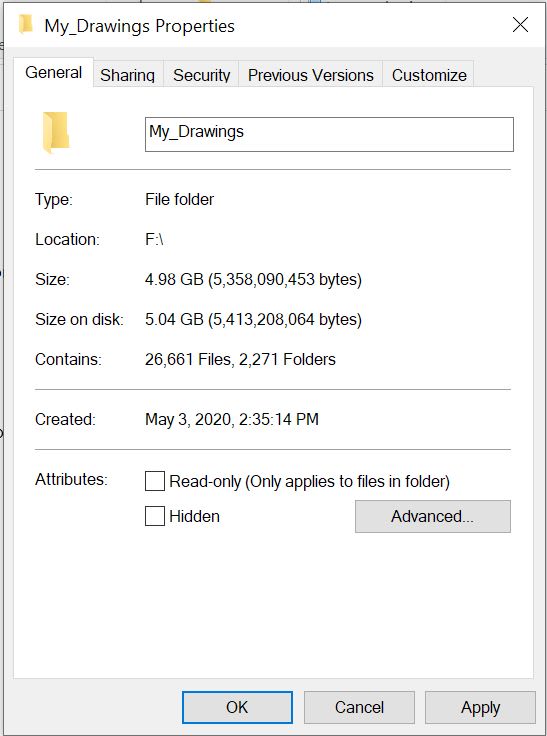

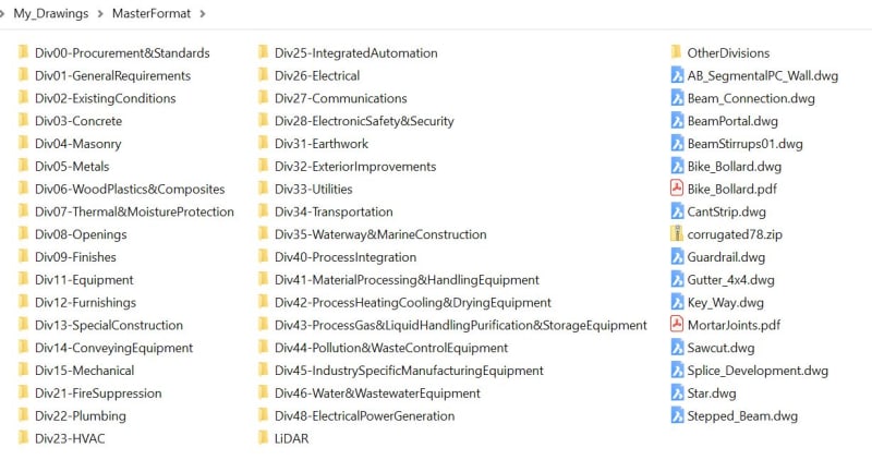

Mostly from my own work, but have accumulated hundreds of details from other work. Log it into a Masterformat type of directory.

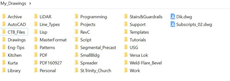

Edit: didn't see your picture when I was typing this reply. Curious what's in the EngTips folder? Memes?

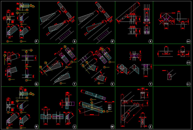

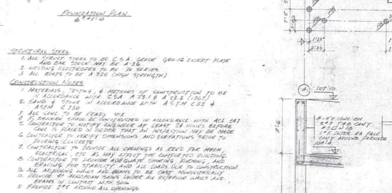

Sorry Kootk, you're wrong! I've got hundreds that I developed from 'scratch'... and any time they were modified, they became a new detail. When I first started engineering, it was common to draft your own projects. This is some of my stuff from '74.
and this is some of my stuff from a couple of years back:

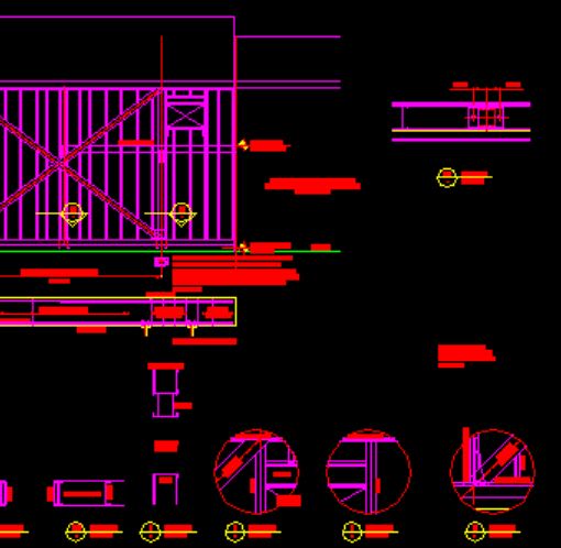

and these are some of my timberframe details (I have 8 or 10 sheets like this for timberframe alone):
All the details are 'tucked away' for use on a future project.
I have similar details for wood, concrete and steel... nearly all done from scratch.
