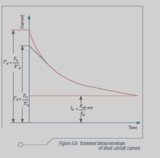

We've a fairly small generator .... 1800 rpm, 480V, 825kW and trying to model this in the power software.
I'm looking this up on the attached Red Book table... Is there a mistake on this table? It shows the X"d is greater than the X'd, why would that be?

Which version of the standard did you get that from? It doesn't match the my copy of the red book, which is the 1993 version (and I believe the still-current version), which show Xd" and Xd' headings on the opposite columns.
From EEP Network Protection & Automation Guide ch.5 page 52 [see attachment] since I"d is more than I'd then X"d<X'd.Somebody change the titles [X"d instead of X'd]
By the way, it is not the actual Table A4-1 from IEEE 141/1993. The actual table is this:
The attachment in my question is out of the Red Book (IEEE Std 141-1993) page 174. My version per the second unnumbered page is "Second Printing May 1996"
9 June 1998Insert to SH16477IEEE Std 141-1993Corrections toIEEE Recommended Practice for Electric Power Distribution for Industrial Plants
Correction SheetIssued 9 June 1998The following corrections should be made:page 161: In 4.7.1 item a), the value of Xs should be changed from Xs = 15/Rs = 0.00165 per unit toXs = 15 ·Rs = 0.00165 per unit.Page 174: In table 4A-1, the column headings were reversed. The first column heading should be changedfrom Xd′ to Xd′′, and the second column heading should be changed from Xd′′ to Xd′. The corrected table is shown on the following page.

Yes. There is a mistake in the table.
