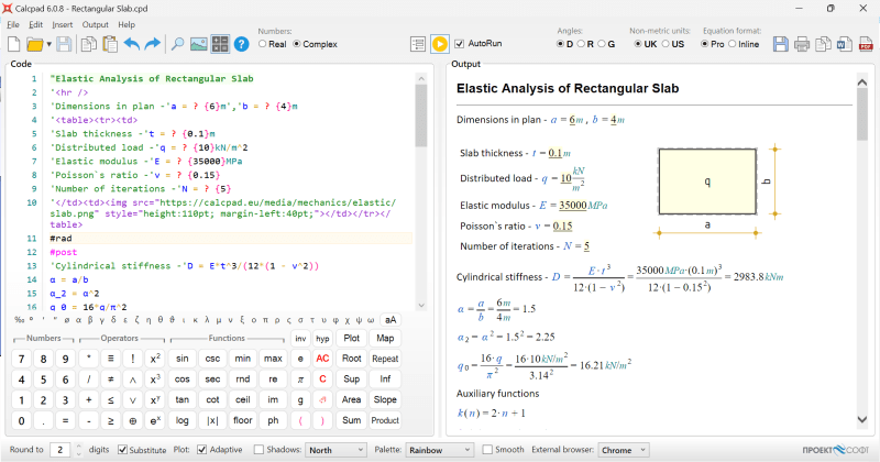

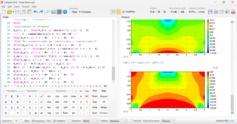

You can also use Calcpad. It is free and open source:
It natively supports units of measurement in formulas.
Also, it documents your calculations automatically to Html, Pdf and Word with variable substitution.
It is easy to learn and use. Just type your formulas and 'text content' in quotes.
