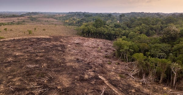

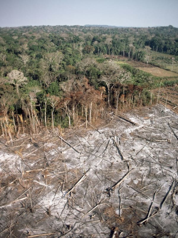

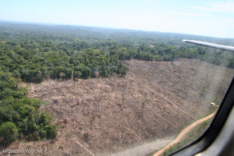

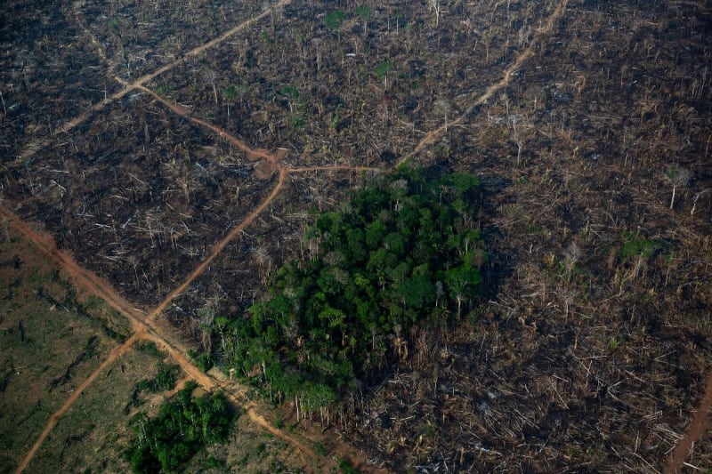

No reason to grow trees for fuel, there are already thousands of acres of trees. All that needs to be done is use tractors/ bulldozers with rakes to rake up all the under growth in forests, selectively log etc.
Lets not waste farm land for engine fuel, that is for feeding living creatures.
No sooner said than done.
Yes, near here are vast gum and conifer plantations that are clear felled at 40-60 years old, and it does look like a moonscape. They are very careful to leave a screen of trees alongside the roads otherwise the tourists get upset. Now fair enough if all this wood was being made into beautiful furniture, sadly most of it ends up as wood pulp for paper, or chips to be turned into MDF or chipboard (overseas) and made into the sort of furniture you see dumped at the side of the road after 10 years.

That wasn't me, but that's OK. I've seen clear cut regions in northern California, and even after 100 years, it's still a moonscape; that would be my fear for any such endeavor. The trees need to be well-grown before cutting them for wood, and the trunks would need to be cleared away before new growth can be sustained.
TTFN (ta ta for now)
Shrug. I've seen old super 8 video of areas north of where I live that were quite heavily clear cut about 50-60 years ago. They're back to well grown bush again.

But, few, if any, trees?
Lots of trees. You would hardly know it was clear cut years ago. Soft wood is about all that would grow well in that area, and 50-60 years grows decent size softwood.
I would have commented on the original question, but it was already answered - all the land would be required and it'd still fall short.
Trees do come back.
I’ve seen a few regrowth forests in Australia that had been clear felled maybe 100 years ago. It looks somewhat unnatural because all the trees are the same size, but it’s a real forest again.
