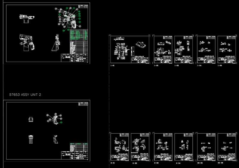

In my case, I have an assembly occupied with many parts (around 50-100 parts). It is a troublesome to export each part one by one into the 2D drafting. Is there any macro or feature I can use to automate this?
Creating the 2D drafting from assembly. now how I'm practicing is i need to select part by part from one assembly product to laid them in the CATdrawing. I just wondering if there's any optimum ways to do this repetitive task.
Below is an example of master drawing for the product in dwg.
Can be done with a script - search for GenerativeBehavior property of DrawingView interface.
Generative Behavior right? okay i'll search and try on this, thank you very much!
