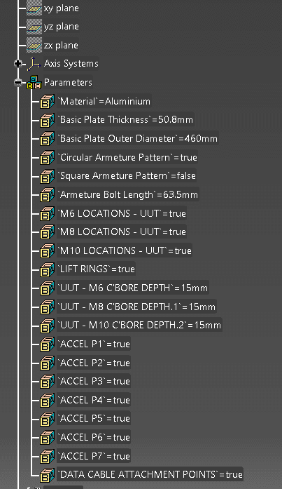

If I'm understanding the original problem, you have the same 10 components in one assembly? I'm assuming the components are constrained in a standardized arrangement.
I've tackled something similar without the use of scripting. It's by no means a 100% successful solution, but it saves me a lot of time on 95% of the projects I use it for. I had absolutely no idea how to write code when I made this template assembly so that's not really a factor. Now that I am able to fumble my way through some coding, it most defiantly could have a nice VBA/userform incorporated into it.

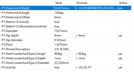

When you use the Formula toolbar/menu just pick the item on the screen and it wil sort to all the aspects about that feature you can control/create relations/formulas with.
Example with just 1 hole feature:
I start with a basic assembly with all my components and use parameters to manipulate sizing. The parameters I show at the bottom control the entire assembly with about 9 unique catparts.
ex:
[ul]
[li]I have a circular plate with bolt patterns, threaded inserts, bolts, washers, etc.[/li]
[li]I use parameters to enter sizing of the plate/dimensions/constraint offset values/hole c'bore/thread/create complex formulas and relations[/li]
[li]I alter the sketch for each bolt pattern. alot of the dimensions are driven by relations/paramters. If I need to leave a bolt location un-used, I just make the point into a construction element.[/li]
[li]Additional boolean parameters activate/deactivate additional bolt patterns/components/constraints[/li]
[/ul]
Once I make all the parameter/sketch adjustments, I just hit update and it populates all the material sizes/component quantities/positions
Features typically used in the assembly:
