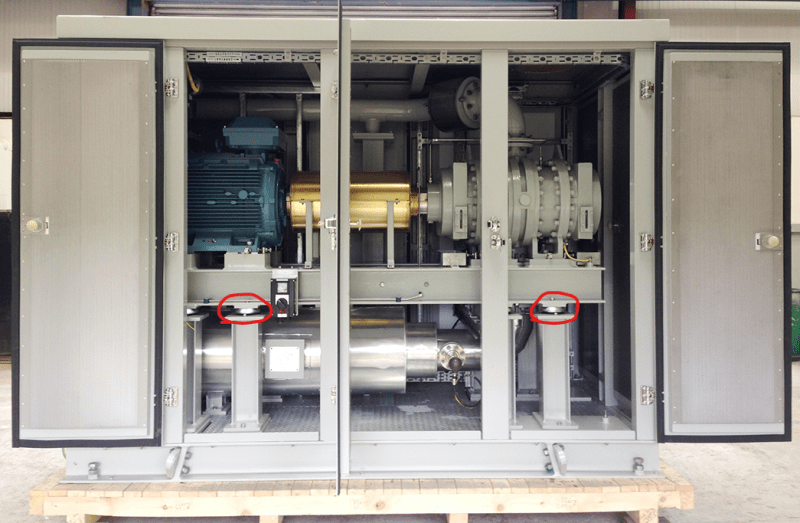

I don't think it is as easy as how you suggest and the reason is that there are an infinite amount of design options. For example, if you have a skid with 4 HEB legs supporting a machine table where the blower and motor is installed I guess some of the torque will transmit down into the concrete foundation under the skid. If you add 4 anti-vibration mountings (AVM) between the HEB legs and machine table, will the loads into the concrete be the same, reduced or eliminated:

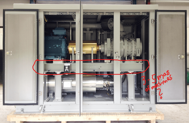

The 3 to 5 mass of rotating machines is also a bit too simple. If the design is using a similar design as here with AVM's... is the machine table (highlighted with red below) itself suppose to be 3-5 times the weight of motor and blower? If yes it is almost impossible even if you fill the table with concrete, I think it will only work if you really oversize it.
Or are we talking about the concrete foundation hosting the full package?
I would guess all dead weight of the package should be reduced from the 3 to 5, meaning that if the complete package is 10.000 kg - 2.000 kg of that is rotating machines then 3 times would be 6.000 kg, but the overall package already have a surplus of 8.000 kg dead weight over the rotating machines to damp out any vibrations. In that case I guess the concrete foundation does not need to be 3 to 5 times the total weight of the package (30.000 to 50.000 kg)?
The "mass rule" is based on rated power and type of machine and is limited to small power capacities. 250 to 500 Hp max. Anything more, and you do a dynamic analysis. It's just based on experience. Rotating equipment 250Hp = 3xM, recip 500Hp =5xM The resulting mass is the weight of the foundation, pedestal blocks, footing block and would also include soil, if there is any soil above a spread footing extending past the pedestal blocks.

If springs are used for vibration isolation, they have no effect on static loads.
They deflect by an amount that corresponds to the torque being produced according to their spring constant, transmitting the resulting spring force to the skid/foundation. They really do not have any effect on changing the torque load transmitted to the skid/foundation when torque is constant.
While rotation is accelerating, they allow some rotational displacement to occur which is counteracted by the machine's inertia, rather than being transmitted to the skid/foundation. Since acceleration only happens during start and stopping of the machine, they are only active at that time and during accelerations caused by unbalanced rotor forces, which can cause vibration.
