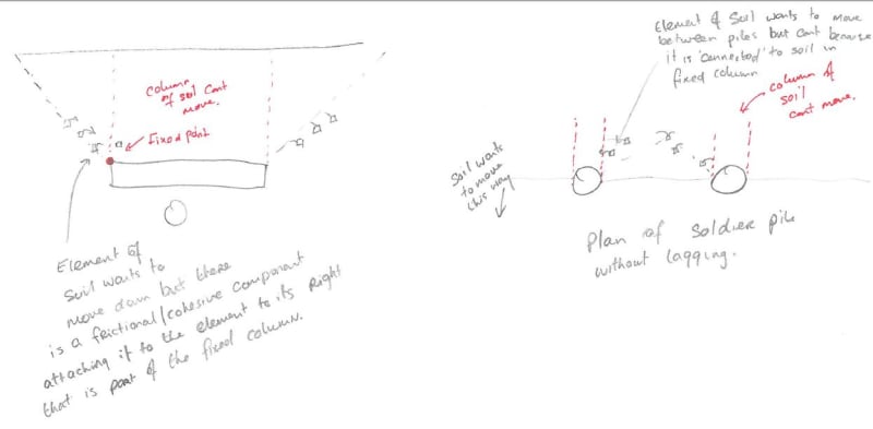

Thanks @EireChch and @SlideRuleEra. I am assuming that there is no ground water at the moment. Also, I accounted for wheel loads to Australian Standards AS5100.2. I am also considering the stormwater pipe to be full. But my question in more related to the soil weight above the slabs. One of my colleagues believe that weight of the soil gets dispersed out after a certain height above the slab. I can't find any literature to support this.
@ErieChch, can you please elaborate on the soil arching effect you mentioned? is it possible to sketch it so I can understand? thanks in advance.

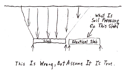

Your colleague's opinion is understandable, but not true. That is why you can't find support. Your colleague would be right, if, you were trying to lift the underground slab... but you are not trying to lift it... it is static. Consider this sketch, ask you colleague what would be the soil load on the identical nearby slab, both of them static. The answer has to be the load is the the same on both slabs. But if your colleague's assumption was true, load on the identical slab will be lower... which goes against the laws of physics. This is tricky, but think about it.

I still believe that the slab will take more load than just the vertical column above it. Because the slab is fixed, the soil either side wants to move by it, but as there is a frictional/cohesive component "connecting" it to the soil element within the vertical column. This adds more load to the vertical column.
With arching between two piles, similarly, more load is transferred to the pile, than the load from the soil sitting directly behind its width/diameter. Soil supports itself due to arching, but this arching adds more load to the piles on either side of the opening.

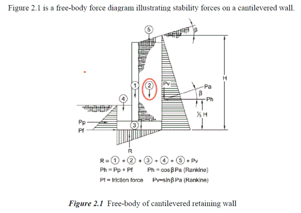

I found the below paper, which discusses loads on buried pipes. I think your slab is similar to a rigid pipe.
Screen shot from introduction below.
