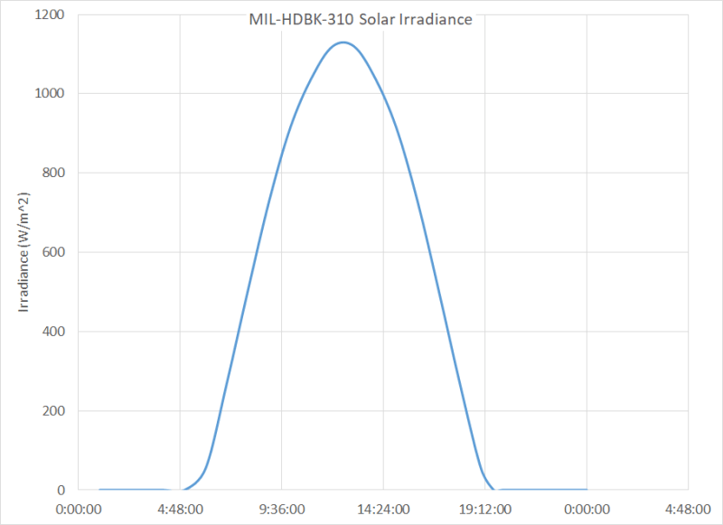

Even ignoring the fact that the OP shows as Alberta located, you can only get maximum sunlight for maybe an hour during the best day of the year AT THE EQUATOR. The rest of the sunlight hours get progressively worse. See for insolation vs. month

I was looking at Solar panels for somewhere near the eqautor and basically you got about 4.5 kWh per KW of nominal power based on 12 hours of sunshine.
So with only 3 hours sunlight you're looking at maybe 1 kwh/kw. Which is about what you need.
but then add on the impact of latitude and you're probably down to about 5-600Whr/kW of panel.
So for worst case you probably need about 2kW nominal power rating to power your lights in winter. Your issue then is how do you control and not damage the panels or lights in the summer when you probably have 4-5 times the electrical power you need or maybe even more given the nights are so short.
some covers for the panels you don't need might be a good idea....
