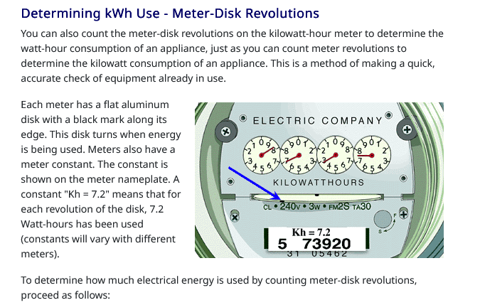

For the main service power, I generally take several spot readings on the revenue meter, each the consumption averaged over a minute or so.
How to take a spot reading on the revenue meter?
That is a chapter on its own.
There is a factor on the meter which indicates the Watt-Hours per revolution of the disk or cycle of the display on an electronic meter.
Note; Watt hours per revolution, not Kilo-Watt-Hours.
The time is typically in the range of less than 20 seconds per revolution, but it depends.
I generally time about 10 revolutions and then calculate the average consumption for that time.
It depends on the actual load, I may vary my criteria to account for heavier or lighter loads.

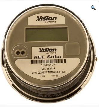

This is the equivalent digital electronic meter.
There is a series of dashes across the bottom of the display.
The dashes either highlight or dim in sequence across the display.
One cycle or pass of the dashes is equivalent to one revolution.
The Kh factor on this meter is 1.0, that is; One Watt hour per pass.
