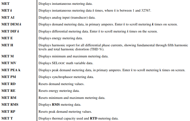

I read through the manual of SEL700G but couldn't find a command that shows the voltage/current/frequency etc. readings
"MET" is the universal (sort of) command for obtaining all the meter data you are interested in. You need level 1 access (Password) to enter the command. In the back of each SEL manual is a listing of all the available commands (blue paper).
MET 1000 should read the metering data 1000 times before stopping. I think you can use ctrl-c to escape from it early.
Here are all of the metering commands

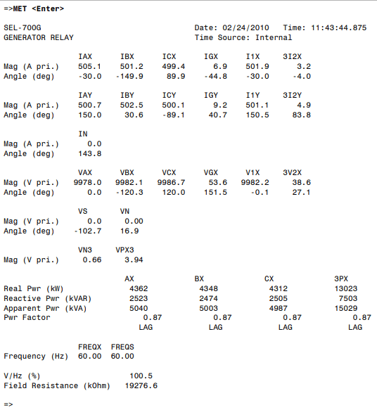

The MET command should display something like this:
