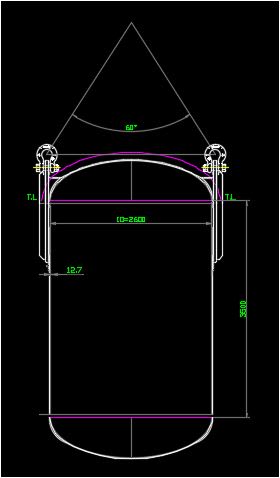

Dear All,
How to consider the ellipsoidal head strengthening effect on the shell where located the lifting lug when analyze the local stresses by WRC?
Thank you.

No spreader bar to be used. Lifting angle 60 deg. This is a real case. This situation is very common.

@ mechengineer
For a lifting angle 60º the position of shackles is incorrect in your drawing.
Rotate them 90º.
Regards
I agree with all of the other posts. If you want to use the current lug layout, use a spreader bar. If you want to use a single point lift with 60 deg lift angle, rotate the lifting lugs and weld them on the head. Typically, we would use 3 or more lugs welded on the head if using a single point lift. WRC is quick, but it's not a great way to look at the stresses on the head from lifting; I recommend FEA and proven hand calculations instead.
Rotating the lugs isn't suitable for the tailing operation. A single point lift would be common for smaller vessel sizes with this arrangement. Using a smaller included sling angle would be recommended, however, everything can be designed for. Angling the lugs in towards the line of action would assist in reducing bending in the lug and prying on the shackle pin but doesn't help with lateral loading on the other components. When the shackles aren't loaded normal to the pin they need to be de-rated accordingly. For a large heavy vessel, I would agree that a simple spreader beam would be recommended for this lift arrangement.

My point is how to consider the ellipsoidal head strengthening effect for the lifting lug local stresses by WRC107 on shell. It may be sure that the ellipsoidal head strengthening effect is significient, if no the ellipsoidial head, thecylinder shall may be deformed.
Due to it is a replacement of existing vessel and space limited, so the preader bar is not applicable.
