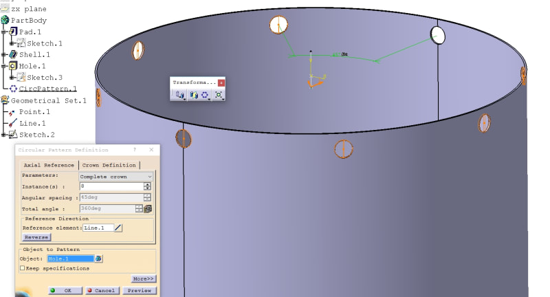

Hello,
In catia,
How would you create regular holes in a rotation object? It's possible to create single holes with "hole" tool, but is it possible to repeat those holes by an angle as this tutorial do on solidworks : Enclosed a picture of the part with manually created holes . Any idea how this could be done ?
Thanks!

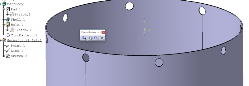

Try circular pattern under transformation feature:
