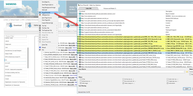

Siemens no longer allows ftp connections to download files from GTAC so if I need to download a lot of files how can I easily do it? It appears there isn't a method to select multiple folders in the pb posts area and when I go into a folder there doesn't appear to be a way to select multiple files.
Any ideas?
NX 12.0.2
Use the DownThemAll (DTA) add-on for Firefox/Waterfox. Best download manager available.
I've been using DTA for years. In fact, GTAC reccomended it many years ago as the best way to download from their FTP & now Akamai servers.
Firefox 57 and above do not support the add-ons like they used to, so I had to switch to WaterFox which is a version of Firefox, but allows the old add-ons to run.
Image below shows how it would work for what you're after.
Plus it makes downloading a lot faster.
