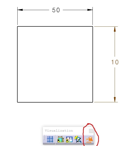

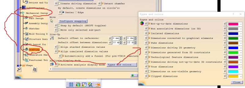

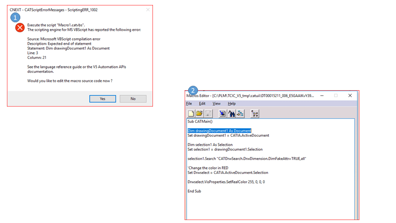

How to find the fake dimension in Catia 2D drafting...... 3
CAD2015
Computer
Jan 21, 2006
2,025
Let's say we got a 2 D file for revision and suspect that some of the dimension are fake.
Is there any way (other than inspecting every dimension) to find them at once?
CAD 2015
You think dimensions are 'fake'?
Do you mean that you think the automatic dim callout has been replaced with a typed-in value (so that the dim would not update were you to change the model)?
The solution to that depends on what problem you're trying to solve...
The engineering department was concerned about a 2D drawing file that had a few dimension that didn't match their expectation. I was put in charge with finding out what was going on.
I found out that one of the dimension was fake (type-in value on Properties).
Tha task is done but I'd like to know if fake dimension could be find easier.......
CAD 2015
Turn on the analysis display mode in the visualization toolbar.
Fake dimensions are then brown in color.
Colors are identified here:
I have always turn on that option pointed by rickyt.
You can use also the macro below which is doing in fact the search of fake dimensions and color them in red if you don't have the analyze option turned on...
Code:
Language="VBSCRIPT"
Sub CATMain()
Dim drawingDocument1 As Document
Set drawingDocument1 = CATIA.ActiveDocument
Dim selection1 As Selection
Set selection1 = drawingDocument1.Selection
selection1.Search "CATDrwSearch.DrwDimension.DimFakeAttr=TRUE,all"
'Change the color in RED
Set Drwselect = CATIA.ActiveDocument.Selection
Drwselect.VisProperties.SetRealColor 255, 0, 0, 0
End Sub
Regards
Fernando
- Romania
- EU
Thank you, RickyT,
Thank you, Ferdo!
[bigsmile]
CAD 2015
Fernando,
I have been trying to apply your macro; unfortunately, I got the error messages below:
What went wrong?
Thanks!
CAD 2015
I see that you are editing in catvbs...please use CATScript as is written in the header of the code section of the forum Code -> CATScript :)
If you want to use catvbs you need to write ' before each As (this means comment, everything which is after this sign will be ignored) so you will have
Code:
Language="VBSCRIPT"
Sub CATMain()
Dim drawingDocument1 'As Document
Set drawingDocument1 = CATIA.ActiveDocument
Dim selection1 'As Selection
Set selection1 = drawingDocument1.Selection
selection1.Search "CATDrwSearch.DrwDimension.DimFakeAttr=TRUE,all"
'Change the color in RED
Set Drwselect = CATIA.ActiveDocument.Selection
Drwselect.VisProperties.SetRealColor 255, 0, 0, 0
End Sub
Regards
Fernando
- Romania
- EU
It works!...
[2thumbsup]
Thanks a lot, Ferdo!
CAD 2015
