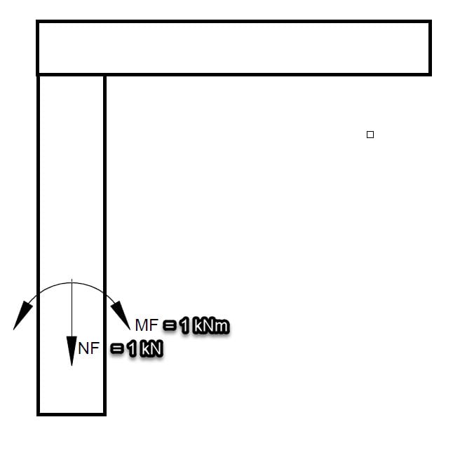

I have this little concrete piece attached to a vertical wall, for which I need to find the thickness "t", which is the same for all the walls that make up the highlighted structure:
The only information I have is the moment and normal force that it will have to carry, and that the reinforcement will have to be approximately similar to a fixed cantilever beam:
To find thickness of walls, where should I start? Should I find the necessary reinforcement to carry the load, and then adjust the thickness of the walls accordingly so that the reinforcement fits? Are there any examples of this, because I could not find it online. It does not have to be exact, I can do with a rough estimate.

We can assume the load is 1kN and 1kNm, and its sticking out 1 m or 1 ft, whatever dimension you prefer to be the easiest. So calculate necessary reinforcement and then adjust thickness accordingly?
I was thinking of just finding previous hand calculation examples on concrete corbel design to find necessary reinforcement and then find thickness of walls.

1. Why are you making a concrete corbel that is hollow? Make it solid - there is no point in attempting to save material when using a strut-and-tie model, since it will only complicate the calculation and still not guarantee that excess deflection of the "corbel walls" does not occur.
2. Why have you drawn a moment in the loading diagram? The load from a part placed on top of the corbel will be vertical and horizontal force, i.e., normal force and shear force, from the deadweight of the structure and the (code-specific) minimum horizontal progressive collapse tie force, respectively. These force components may be designed against using the strut-and-tie models for corbels found in the literature.
Remember that external moments and internal moments are not the same thing.
PS. If this corbel is supposed to carry some type of crane (you mentioned that in another post in this forum earleir this week), you may also consider making the connection a steel structure that is bolted into the wall. Tall and heavy cranes are most often carried by a braced steel frame, and not by concrete walls.

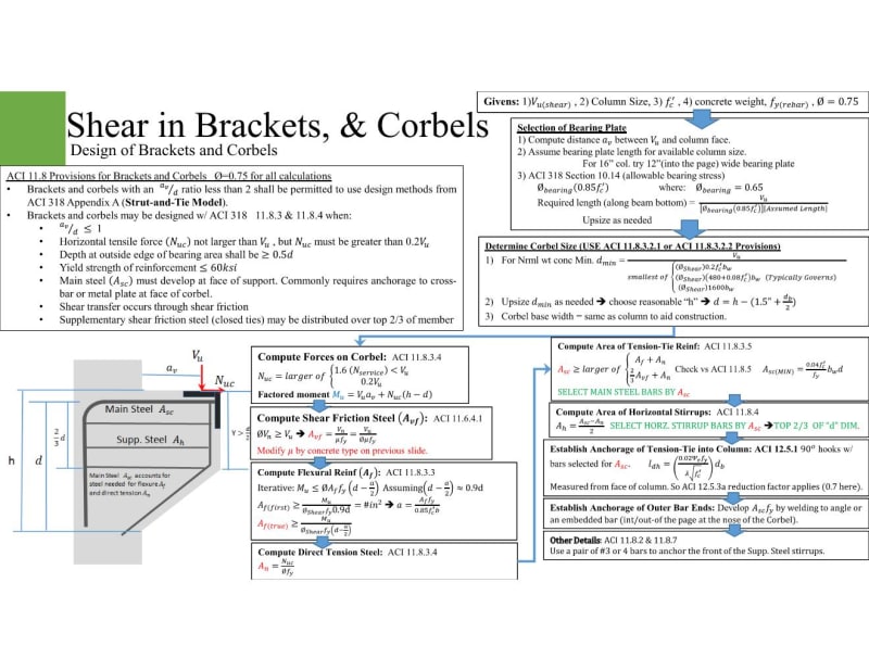

I've only got a little bit of info on Corbels, but I hope this old study slide helps a little.

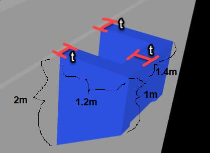

The dimensions are given below, and I need to find thickness "t". I dont know how the loads from crane will be distributed on this structure, I dont think I have enough information, so I just have to make assumptions for worst case.
That is one step. How many tonne or ton is the crane? Presumably you know the spacing of the corbels and the span of the crane? From those numbers you can start to nail down the magnitude of the problem. As an engineer you sometime must say no, I cannot design this based on the information I have.
Why do you write "the dimensions are given below"? You are the engineer - you decide the dimensions, and as an engineer, you should know that strut-and-tie design of corbels does not involve thin walls! Make the corbel solid and start the investigation by thinking about the problem parameters, including those mentioned by user "Brad805".

Assuming its all reinforced concrete, make the whole thing solid and design it as a normal corbel of which there are countless design examples within textbooks.

Thank you, it made no sense when I looked at it in my FE model. I think regular concrete corbel design is the way to go.
