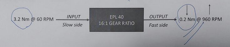

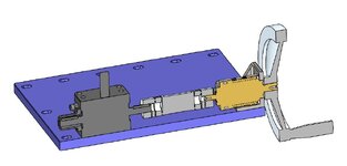

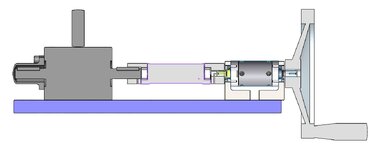

Hello,
I am wondering how is connecting a planetary gear to the attached sub-assy is recommended?
I used 2 brackets, but I am not sure it's ok.
I don't know that I've ever seen one fixed rigidly on both ends. That thermal expansion needs to go somewhere. They are always fixed on the low speed end.
