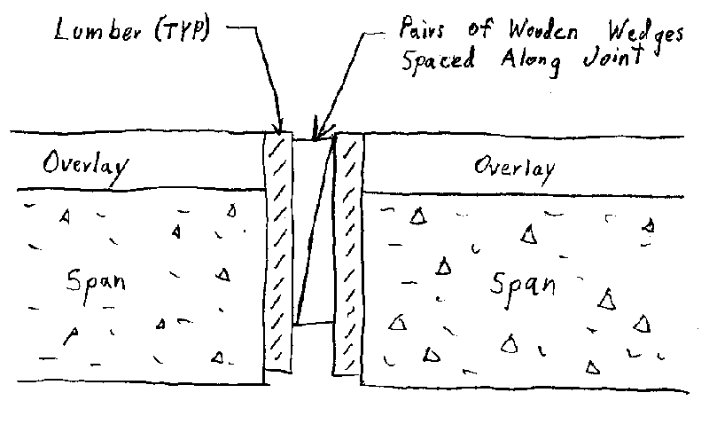

We are having a problem with the way that contractors are protecting and curing the edge between spans on bridges during an overlay after milling. Right now they are using a piece of Styrofoam, but the piece moves while the overlay is being placed. I have looked for other methods for the gap between spans to be formed during the overlay without any luck. I was just wondering if anyone had a good method for protecting the gap between spans while creating a straight edge along the concrete for a bridge expansion joint system to be placed in.
Thanks,
I have used A36 Steel Angle for Polyester Concrete Overlays. We would pot them in Hydraulic Cement.
The TKAT - I assume the joint is open, as used for Neoprene compression seals.
How about lumber forms against each span, held in place by friction for pairs of wooden wedges spaced along the joint. After curing is complete, drive the wedges down and out of the joint to allow removal of the lumber forms.
