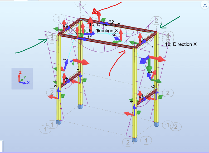

I am new to steel design, I have background in reinforced concrete and geotechnic. I am studying a simple shed in Robot software. Since there is no connection that will transfer a moment between a beam and the WEB of a I column (red beams in the y direction with the yellow columns) I had to release the beams in the y direction to be pinned pinned. As a result, I had to make the supports rigid. Is there another (better) way to achieve stability in the y direction?

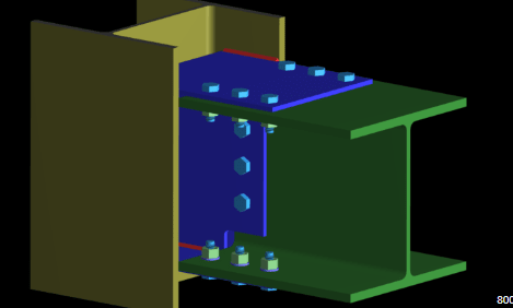

You can do a weak axis moment connection into a WF column web. Something like this:
is the OP talking about limitations of "robot" software ? (rather than the practicalities of how to do it ?
OP here. It seems the bracing (very light cyan color in the picture) are not working properly as they were assigned a property Flexion Only. If I remove this property and make them Pinned Pinned, the instability disappears.
Thank you all for your replies.
Looking at the left frame only (since both cyan braces have opposing direction). The brace will be in tension if the lateral force is Y+ but compression in Y-. If the applied load is Y- and you've a rod defined, then you literally have "no bracing" and vice-versa for the right frame. That is probably why you are getting instabilities. Green arrow says OK, Red not good
Why not just a beam end plate to the column? There's various ways you can do it.
