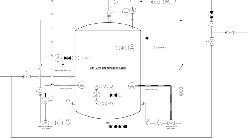

I need to model the existing oil and gas upstream facility in P&ID. For now I'm focusing on the vertical 2-phase separator's liquid control system.
The separator has two liquid dump sides, one is usually closed and the other is usually open, but I still need to model both of them in P&ID. Both sides have a floating ball inside the vessel that detects a liquid level, which is connected to the trunnion, and then the receiving fulcrum. The difference is that one is a (1) lever operated, while the other is (2) pneumatic-operated type.
I came up with some preliminary P&ID for the liquid control portion of the 2-ph vertical separator (attached image). I know that this is massively wrong, so I'm looking for feedback.
Q1. To my understanding, the T (transmitter) in P&ID is intended for devices that send electric signals. The way I modeled seems to be wrong because there's no electric line that sends liquid level information. But I don't know how else to connect the floating ball + fulcrum combo to the actual control valve. What should I do?
Q2. On the (1) side with a lever operated valve, I'm not sure what symbol I should use. I used diaphragm-type symbol for both sides, but I think the lever-operated side should be using a different symbol. Any recommendations?
Q3. On the (2) side with the pneumatic-operated valve, I'm not sure if I can use the LC + LY combo for the pneumatic system. I used LC+LY combo because that's what I commonly see on P&ID examples I found from other people, not sure if its applicable in my case too

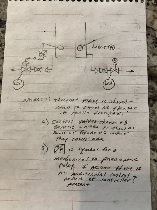

On the purely mechanical side a ball will be shown in vessel with lever and mechanism connected directly to valve. On the pnuematic side a ball and with lever will be shown connected to a mechanical/pneumatic relay with pneumatic tube symbol connected to valve diaphram. I will see if I can find some typical P&ID symbology for that. There are no transmitters. Remember that all symbols on a P&ID represent an actual physical item that it really is. A transmitter is a control device which is basically a single control box that takes an input signal from the sensor in the vessel, pipe, etc. and converts this signal into a variable electronic signal or variable pressure signal and sends this signal to the controled device such as a valve.

Just draw it as best you can and don't call things transmitters if they don't transmit anything....

Notes on a P&ID are your friend. Use them.

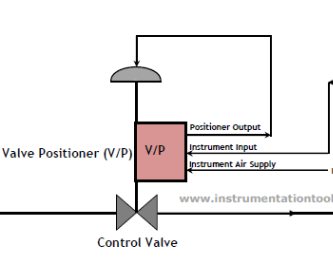

This is something similar. Its an inlet valve but the same symbol would do. For your air controlled one just show the ball cock mechanism entering a pneumatic valve positioner in place of the normal 4-20mA signal.
Si in place of the "Instrument input line" just show a line going to the ball cock and add a note to explain what it is.
@LittleInch
I think your 2nd image is what I'm looking for. I think I can replace the "Instrument Input" with "Trunnion & Fulcrum" to describe what the input signal really is. For the lever operated side, I guess I can just take out the instrument air supply line and remove cap on the control valve, and just replace with with horizontal line to indicate lever.
While waiting for answers on this post, I came up with a new drawing, wondering if this is acceptable too. Notably, I'm using "LC" to denote the floating ball level detector as a control device that activates the "Trunnion & Fulcrum" line (This would correspond to "Instrument Input" in the 2nd image of @LittleInch's comment). I couldn't find a standard way to describe trunnion and fulcrum so I used that patterned line, not sure if these are acceptable in the eyes of yall P&ID experts (I know my customer probably won't care, but still would like to know yall's opinion). For the pneumatic valve, I put description "PNEUMATIC-CONTROLLED DUMP VALVE", and the other one as "LEVER-OPERATED DUMP VALVE" for clarity in readers' eyes.
Looks OK to me.
Just add a couple of notes.
Must admit I've never seen anything like this. Is it 100 years old?

One thing are you sure they are drains and not water supply? Normally that type of setup is used for supplying water to a system such as a cooling water system cooling tower makeup. These types of mechanical valves are not that common in use.
In any case the lever operated valve symbols shown are standard symbols used for that type of valve. You can find this symbol in the standard ISA symbols. However as a P&ID developer you have the liberty to modify the symbols when needed to apply to your installation as you see how I have done.
I am not sure if the pneumatic control is just a mechanical to pnuematic relay or if it is a more sophisticated control device. I think it is just a relay with input as the movement of the lever rotation to opening of control air valve to the diaphram but there could be other devices such as positioners and limit switches associated with this valve that keep it in the proper control range.
Also you could show the actual height of the floats in the vessel when the valves are actuated, if a range of levels then you can show levels of on and level of off for each float as upper and lower lines at the floats.

Thanks for the detailed sketch, really appreciate it. That M/P symbol and the lever drawing seems useful for future drawings. FYI these are for sure 2-phase separators. The inlet is the pressurized wellhead stream that needs liquid-vapor separation. The separated liquid from the 2-ph separator is then dumped into a 3-ph heater treater for water separation (not shown in my drawing).

I did not see that indeed, thanks for noticing and commenting again. It def looks helpful.
