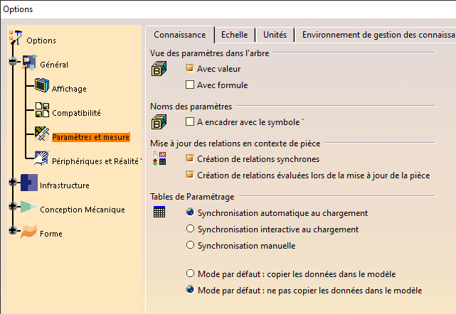

I'm actually asking not about how to avoid, but about how to enable. I can't achieve automatic law evaluation using sample part from documentation ([tt]KwrObject.CATPart[/tt]).
Can you please provide a sample part that would have a law that runs a script on opening?
I guess it depends on the conditions of the law and some settings. I join a part and a screenshot of my settings. If I open this part, the law is evaluated and therefore the according macro is launched. The macros should be in D: but you can change the path in the law if you want.
Thank you, now I finally got it working.
