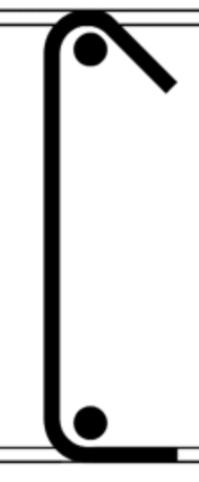

So the code is asking to provide cross-ties, not the closed-ties like above?. So, should it be like following tie? (the reason I'm asking this is, if I use "closed-ties" x 4 units, the r/f area doubles than "cross-ties")
Does the code state to use "cross-ties" in-spite of "closed-ties"?
can anyone please confirm if it should be a "closed-link" or a "cross-tie"? the reason I'm asking this is, if I use "closed-ties" x 4 units, the r/f area doubles than "cross-ties"

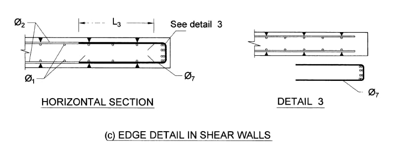

- If the compression reinforcement in the wall DOES NOT EEXCEED 0.02Ac , the wall could be reinforced assuming that only end zones resist moment,provide both ends with U shape links ..
- Provide cross-ties for the mid section btw the boundary elements , end zones..

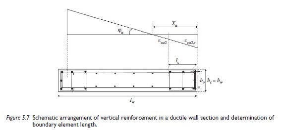

The following is snap from Manual for Detailing Reinforced Concrete Structures to EC2 ( by JOSE CALAVERA)
...and Ductile wall (from FARDIS)
