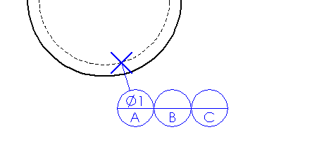

How to make multiply datum targets (balloons) in SW like the image? 2

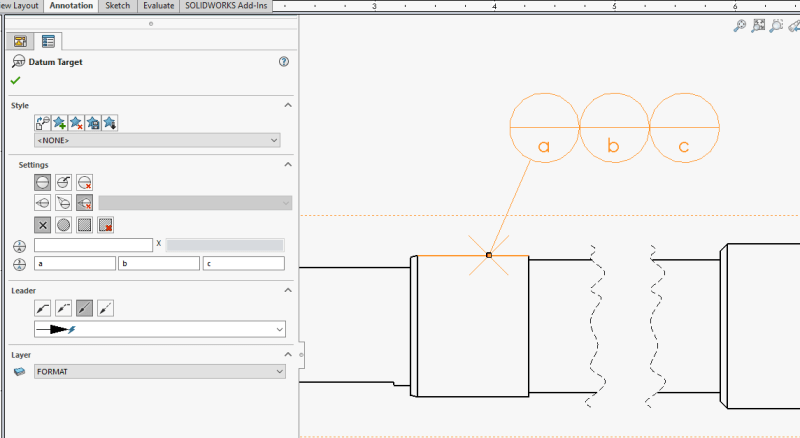

E-Stone,
Use the Datum Target Properties tab, see image.
