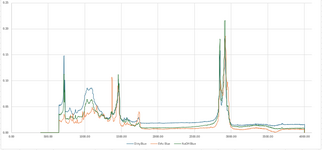

@IRstuff Unfortunately, there was no measurable weight change before and after cleaning the flakes.I cleaned the flakes using two different methods:
Caustic Wash – A solution of 0.5 wt % NaOH and 0.3 wt % polysorbate 80 was heated to 75°C, and HDPE flakes (1/4 of the weight of distilled water) were stirred for 10 minutes before drying.
Solvent Wash – A separate sample of flakes was cleaned using a 22.5 g ethyl acetate + 25 g distilled water mixture, stirred at 480 rpm for 10 minutes at room temperature, then dried.
Currently, I dont have access to pyrolysis GC-MS, but FTIR analysis showed a reduction in sulfonate and ester functional groups (1000–1100 cm⁻¹ and 1700 cm⁻¹) in the cleaned samples. I think these may be linked to additives added in engine and gear oil, though I am not sure.
