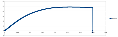

Thank you for your response. I appreciate your suggestion about using the RVE approach for analyzing complex infill patterns. While I understand its potential applications, I believe my case might differ slightly.
I am interested in developing a material model that captures the mechanical response of a 3D-printed specimen depending on the orientation of the printed layers. Based on tensile experiments I conducted, I observed that the stress-strain curve varies significantly with the layer angle. My specimen is a rectangular sample composed of multiple layers, each with the same or different orientations (raster angles).
Since my sample does not have any infill patterns (just longitudinal or transversal lines), the RVE approach would not be applicable here. I have already tried modeling the material as a laminate with anisotropic plasticity and using a ply stack (as a composite), but the results do not align well with the experimental data, particularly in terms of failure behavior, which differs significantly from what I observed in testing.
My goal is to develop a model that better captures the anisotropic and layer-dependent behavior of the material. Would you have any suggestions for alternative approaches or tools that might be more suitable for this scenario?
Can you share a picture of the test specimen ? Maybe it can be just modeled as a solid with layers or otherwise represented with the whole printed pattern.
i have this strain stress from a tensile test strain stress.pngBut If i try to simulate in abaqus instead of observing the expected plateau in the results, there is a noticeable drop in force at plastic deformation. I’m attaching one of my test models to help illustrate the issue.
