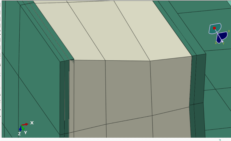

I am working on a composite layered structure with a shell layer-solid layer-Shell layer sandwich structure. How to offset the shell layers on both sides by 0.25mm without having to re-create shell offset layer and rebuild the boundary conditions, surfaces, nodes on that shell layers ? The structure is a little curvy so which offset method could be used to offset the shell layers ?Is there any offset method or should the model be rebuilt from scratch ?
I tried the section manager-> edit and apply shell thickness and offset from section value(offset=0.16665 trial and error) and assigned a thickness of 1.5 for the shell layer. But because I have curvy shape for the shell structure, it is penetrating into the solid layer as shown below.

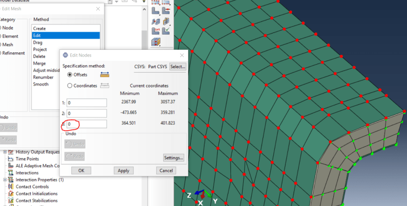

I know there is an option in part module->tools->node->edit. But because of curvy shape if I give z coordinate for offset value as shown below, it will still penetrate at some locations in x and y directions. Does any one know how to offset the shell layer by 0.25 mm in this situation ?
Many thanks for any help!
