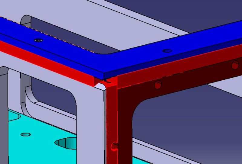

By the way I have another problem, I'm using the welding design feature, I have this situation:
where 3 different weld seams should reunite in 1 vertex, is that possible to create a continum seams instead of the 3 different seams that leave the empty volume zone?
Thanks.
