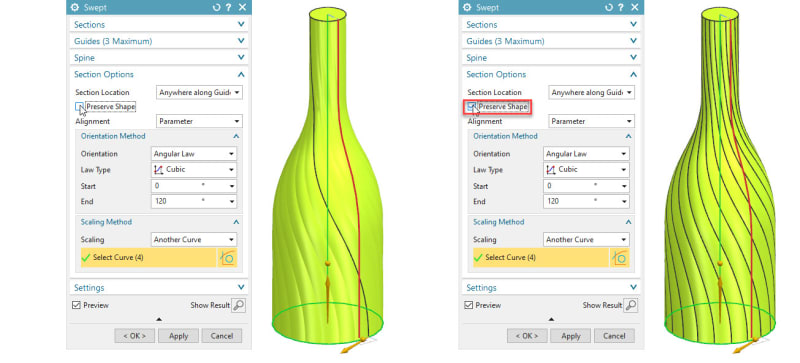

how to sweep without edge blend? (NX12) 3
It's not a 'blend', it's the profile of the model being an approximation. There should be an option with the word 'Exact' in the title. Toggle that option 'ON' and see if it helps.

Hi Quentin,
Set the switch Preserve Shape
Regards
Didier Psaltopoulos
"As said above", NX will , unless you tick the "preserve shape" approximate the entire selected profile using the distance tolerance. You will probably only get 2 faces on the total sweep.
with the Preserve shape NX will still approximate if needed , but it will honor the section segments.
This is done to save computing power, you might else get "data-monster-surfaces" , i have seen a Part with 2 faces and the file size was +40 Mb.
since the shape in that +40 mb part should be a smooth hydrofoil, the file size is an indication that the faces are overloaded and most probably not smooth.
