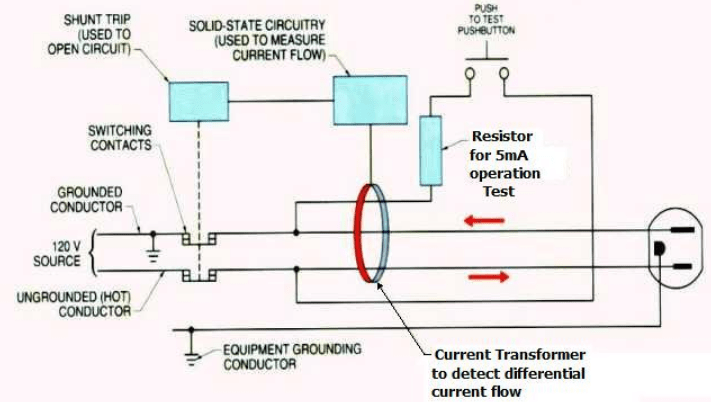

So does pressing the TEST button on the GFCI receptacle do this very thing, or does it merely inject a pilot signal partway through the trip circuitry while not actually applying a high impedance ground fault?

bwen08 has it. And yes pressing the test button is the UL listed CORRECT way to test GFI outlets. It simply and reliably causes a ground fault that a working outlet will trip correctly with.
If you have a GFI breaker and want to test outlets elsewhere then a commercial tester would be recommended. Bill's recipe would work for that too but is not so good for the general public. If you have a person capable of doing electrical things safely you can make a tester by acquiring a plug that can be installed on cords and instead just wind the appropriate resistor as Bill showed around the screws and then when you want to test an outlet you just plug it into the outlet of interest. This can be good when a GFI outlet is daisy-chained down the wall or on the other sides of a wall. Just looking at an outlet doesn't tell you if it's GFI protected or not but plugging the tester/test-plug in will test it.

In my experience, the GFCI receptacle test button works even on two-wire circuits with no ground wire. The test button cannot create an actual ground fault, but must cause a differential current.
You're right stevenal that The Button works on 2-wire circuits. I have several unfortunately. The imbalance is created thru the same balanced current coil by simply adding another sensed wire thru it that is not compensated. The test current is created across the hot-neutral. It still tests the circuit perfectly.

The fancier plug receptacle testers include a button for testing GFCI receptacles; which presumably does the exact same thing as the button on the GFCI receptacle itself
TTFN (ta ta for now)
The external tester would have to leak to ground rather than back to the neutral the way the test button can. With an open ground it might not trip a good GFI.
