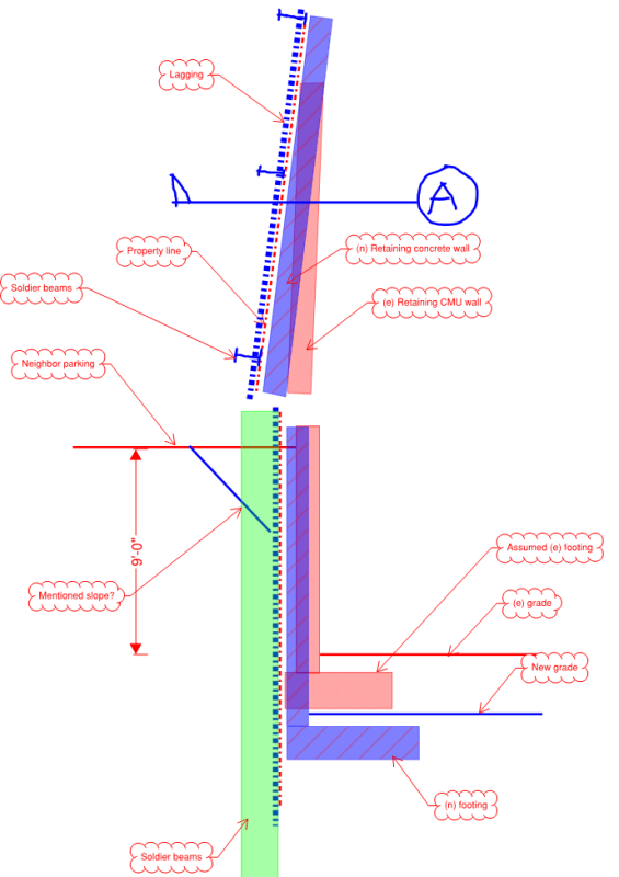

Please see sketches below to understand the situation. I know this is pretty common but I don't have much experience in how shoring contractor works and what their capabilities are so I am not so sure how to install soldier piles in this particular area to build the new concrete wall.

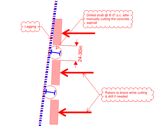

Does it make sense to brace the existing CMU wall then saw cut 24" or more wide vertical strip including existing foundation (if we can't core through it) at the soldier pile locations for drilling then install I beam as normal? What else can you do in this case?

In my opinion, it would be easier to do the following:
1. Demo the existing wall that projects above the neighbor's paved lot.
2. Design cantilevered, temporary sheeting and get permission from the neighbor to install it as close as you can to the property line and on the neighbor's property.
3. You don't show elevations so I do not know how high the sheeting wall needs to be but it looks like it could be cantilevered - even though you might ask if you can slope a little of the neighbor's property in order to reduce the height of the sheeting wall.
4. Build up in front of your existing wall if necessary to drive or drill-in soldier beams as close as you can to the back side (property line side) of the existing wall.
5. Demos the existing wall below the top of the soldier beams in sections of about 3 to 5 feet while installing wood lagging between the soldier beams.
6. Continue demo and lagging until you reach the subgrade of the proposed new wall footing.
7. Build the new wall tight against the sheeting wall.
8. The temporary sheeting can then be cut off and removed to about 2 feet below finished grade in the neighbor's lot.
9. If you got permission to slope some (maybe about a foot or two) of the neighbor's property, then the tops of the soldier beams would already be a few feet below finished grade and would not need to be cut off and removed.

I got a bit confused. Let me know if I understand correctly.
So if the neighbor is ok (very unlikely), we install soldier beams on the neighbor side as close as possible to the property line. Where is the cantilevered sheething? and why do we need that? I am not so sure I get the picture. Do you think the sketch below is correct?

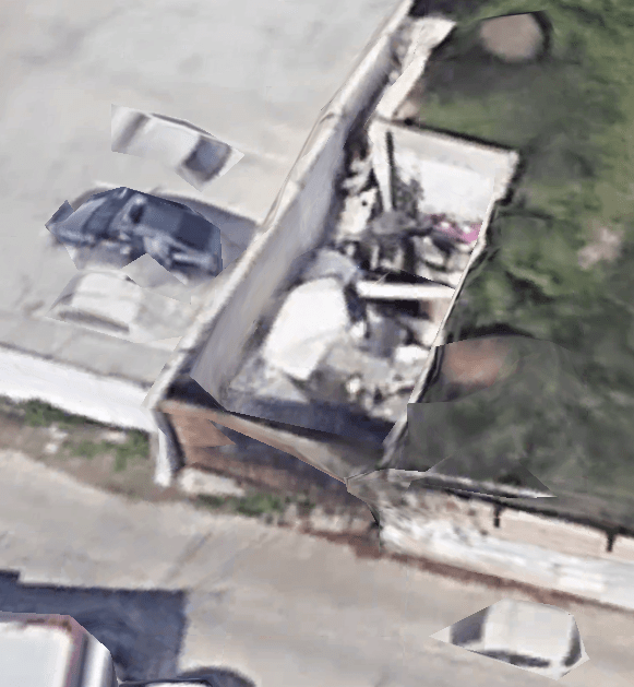

Satellite view of the situation.
As I in interpret PEincs proposal, the purpose of the temp sheeting is to allow you to install the Solider Piles and lagging while not losing material. I am assuming the temp sheeting is essentially trench sheeting as I would call it, very thin sheet piles essentially. Like a U shaped sheet pile that is 100mm in depth.
This is installed as tight to the boundary as possible, however it it looks like you will need to steal some space from your neighbour. That is the benifit of the temp sheeting as it isnt as beefy as permanent sheet piles.
Your piles are installed at the back of your existing wall and then up to your boundary line. It is only your temp sheeting that may encroach into your neighbours property.
After removing the upper portion of the existing wall that projects above the neighbor's original grade at the wall, the temporary soldier beams would be installed on the neighbor's property, as close to your existing wall as possible. As you start demolishing the remainder of the existing wall in sections about 3 to 5 feet high, you will install wood lagging between the soldier beams to support the neighbor's property. When the entire existing wall has been removed and the lagging has been installed down to the proposed subgrade of the proposed, new retaining wall, the soldier beams will be cantilevering without needing any other bracing or tieback anchors. Generally, cantilevered soldier beam walls are ABOUT 12 to 14 feet maximum height. For soldier beams spaced at 8' c.c. with a total lagged excavation of about 12 feet, I ESTIMATE that the soldier beams may be ABOUT HP12x53's or HP14x73's about 25 feet long. This is just an educated guess - NOT A DESIGN. You must prepare your own design using all site specific earth and surcharge loads.
If the total depth of your excavation below the neighbor's property is higher than that, you may want to ask him if you can temporarily slope and excavate a few feet deep in on his property and within about 5 feet of the soldier beam wall. After your new wall is built and the soldier beams are cut off a few feet below finished grade, you backfill behind the wall on your neighbor's property and return his property to original or better condition.

Do you still think that it's not wise to brace the existing wall then saw cut the existing wall & footing (in 2ft wide strip @ 8'-0" o.c.) to make space for soldier pile shaft drilling? It sounds like labor intensive and costly but it's still technically feasible, don't you think?
It depends on the capabilities of the contractor and his equipment. Will you be leaving in the remaining portions of the wall or removing them in lifts as you place lagging? How close to the existing wall can you drill? Drilling equipment might not be able to get close enough to install the soldier beams back where you want them. What retains the original wall backfill (under the parking spaces) when you cut the slots in the wall? You may need lagging in each soldier beam slot. Then, this lagging will be in the way of drilling for the soldier beams.

This may clarify my idea.
I hope arching effect can hold the soils in the open strips and hope we can ask the neighbor not to park cars near the cut.
