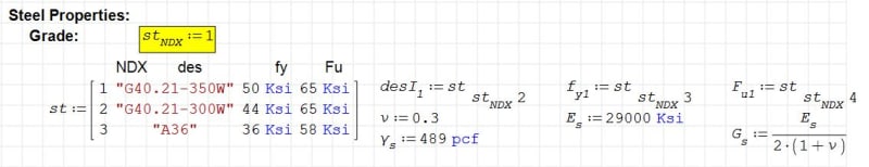

Sorry pham... but I often encounter projects in Canada where the BAR and plate material is spec'd as ASTM A36. I have no idea of what the supplied material is, but I consider it as A36 for my calculations. In Canada, you can get both CSA G40.12-44W as well as -50W, and not be guaranteed that it will will all be -50W. I've checked with the fabricators on this.

pham... I have no idea of what the material supplied is... it just a matter of selecting the spec'd material in my SMath programs
and it all comes out in the wash...
