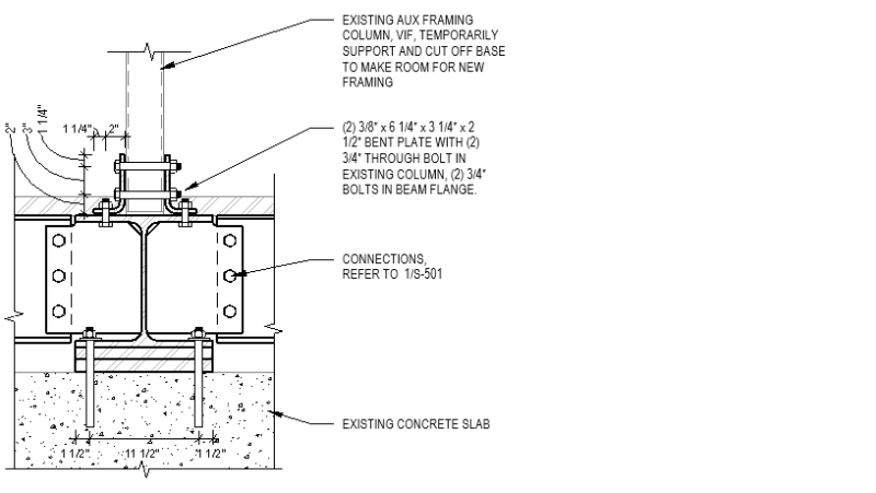

The equation in the manual (7-15) is only considering one side of the HSS to contribute to the bearing strength of the bolted connection (Apb = n*d*tdes). This would be the case for the connection shown below. The applied load will be supported almost entirely by the wall of the HSS that has the steel angle attached to it.
I imagine that your connection configuration is one where the load is being applied equally through both sides of the HSS, in which case you would be correct that you can include both sides of the HSS in your bearing strength calculation (Apb = 2*n*d*tdes).

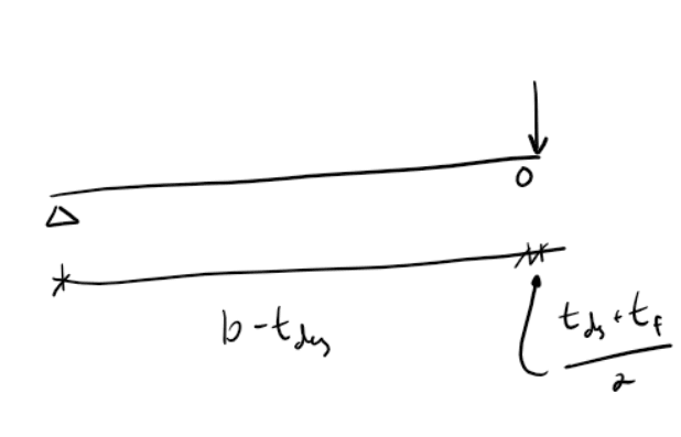

To show ProgrammingPE's example another way:
Where b is the width of the wall, t[sub]des[/sub] is the design thickness of the tube, and t[sub]f[/sub] is the thickness of the fixture (angle leg in the section posted above).
Programmer PE, yes, I am supporting an existing column for vertical load only, we need to avoid any welding in the field. Image below.
Dave and Pham, thanks for your thoughts.
IMO AISC needs to modify the language in the manual to clarify. Or better yet just delete the manual equation and refer to the specification.

Even though it is a bolt through the HSS, you don't have a nut/head combo on each wall. Without the compression on the surrounding material and resulting confinement, you can't use J3-6a/b for tear out and bearing for a bolt hole.
So what you have isn't a single shear bolt or a double shear bolt, you have a bolt acting like a pin that is relatively free to move around in the bolt hole. That's why you end up with the cantilever arrangement I alluded to with my FBD.
