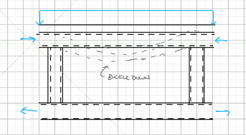

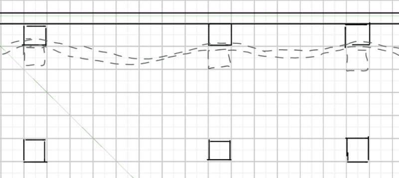

I would think the loading from the slab to the top chord would initiate a downward buckling mode and since this is likely a system of trusses all wanting to buckle downward the slab would really just go along for the ride and not provide very much if any restraint, I'd land on treating this like a wood stud in a stud wall the sheathing can brace the out of plane buckling but in plane it has little effect so the unbraced length is the full stud height.
Panel without diagonals shown:
System of trusses and slab with the top (compression chord) all buckling downward:

Maybe. It looks like the top half of a scissor jack to me. Also, weight doesn't add stiffness - you're still pushing against EI which is why I think the slab needs to be connected in a way that it becomes a strongback to the chord.

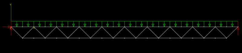

I ran buckling analyses of UDL on a truss top chord vs point loads at the chord-diagonal intersections. The UDL had slightly lower elastic buckling load (a few %) which I think is due to the initial bending in the chord pushing it slightly out of shape.

Or it could just buckle in the opposite direction assisted by the weight of the slab and P-delta effects....
For the primary in-plane buckling mode you will have alternating up/down/up/down buckles between the nodes.
This mode is constrained if the upwards buckles are constrained.
I agree with you guys that it should be quantified in some way. I’d just be surprised if the slab doesn’t get it over the line. OP suggests it’s pretty close with no restraint.
