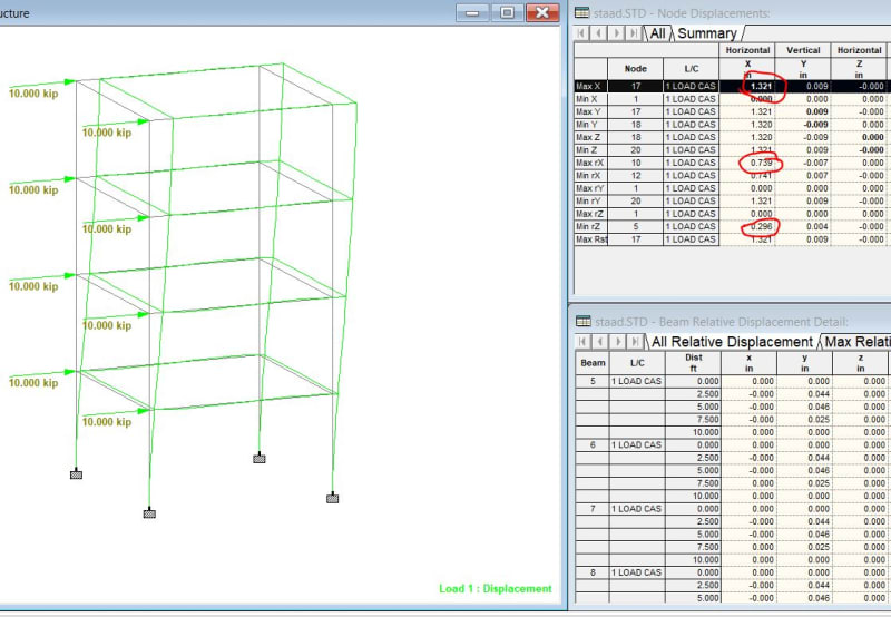

When i set all the factors to 1 the floor displacement matches, i did a simple structure as Agent666 suggested. A four story single bay structure with nodal load of 10 Kips. This time i modeled in STAADpro. and here are the results

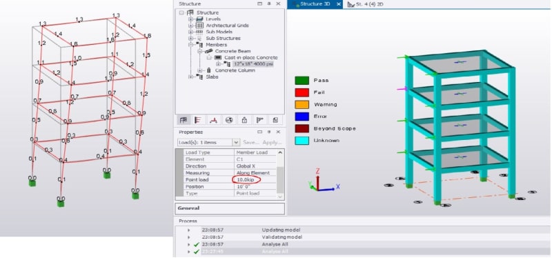

and the results in TSD :
One more thing : if you observe the first picture i posted the Supports were Pinned, this time they were Fixed
