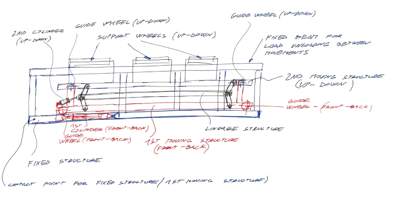

I could improve in hydraulic systems, but when I design a machine, I sometimes need some details regarding this area and now is this situation.
Let's say we have a machine consisting of a fixed structure and a moving structure. We move the second structure relative to the first one with a hydraulic cylinder. Now, we have two options for how to fix the second structure in the end position:
1: We don't use a total stroke of the cylinder, but instead, we design both structures so that they have some common points that come in contact before the cylinder reaches the end position. Both structures are somewhat locked to each other. Of course, we need to keep the pressure in the hydraulic system. We also need to design structures strength-wise so that they can withstand these contact forces.
2: We use the full stroke of the cylinder, and there are no common contact points on both structures. We lock the structure in the end position with the cylinder end position. Of course, we keep the pressure in the hydraulic system.
Cylinders are slow-moving; no dynamic or inertia forces are coming into play.
Which one do you prefer and why? Intuitively, I like the first one more.

"Cylinders are slow-moving; no dynamic or inertia forces are coming into play" - Wanna bet? If it's moving, there will be some forces.
You can either take up the forces within the structure or you can absorb the forces in the gland of the cylinder.
If your cylinder manufacturer has done a good job, the gland on the end of the cylinder will be capable of withstanding the full force at the maximum working pressure. The downside of stopping the stroke with the cylinder is that there is no room for flexibility. If more stroke is required, a new cylinder will be required. If you stop the stroke with a mechanical device, it can be moved, but it needs to be strong enough to resist the cylinder forces. That is the total cylinder force, push force + inertia.
Ok, I'm attaching a quick sketch of how I plan to approach this.
In the sketch, you can see the side view of one part of the machine, which has a total length of around 6 m and a height of 1 m. It is a support bench for cylindrical pieces (weight up to 70 kN, length 6 m). We use the bench part of the machine for front-back and up-down manipulation of the part.
In the front and up position, we do some machining on one end of the part (groove grinding and cutting a short piece from the blank) and then move the part up and front to repeat the operation.
I'm still in the design phase, but as I mentioned, I'm choosing between two options. I see the first option as a better one because we still have some manipulation possible in the cylinder for different reasons (tolerances, deformations, etc.), and the structure becomes more rigid during the machining phase than it is if only cylinders are at the maximum extension. I have a position for the first contact point (front-back cylinder) but am still looking for the clever position of the second contact point (up-down cylinder) because there I have a linkage mechanism, which produces big forces in the up direction, so I want to transfer the forces in the cylinder actuating direction.
Either approach can be valid. It will come down to the details. I suggest doing a pro/con/risk analysis/comparison of the 2 methods in your design situation to help you decide.

Okay, thanks for the input. I'm not very skilled in hydraulic systems details, so I was wondering what the second option could cause to the hydraulic system or if there could be any potential problems. That's why I asked under this part of the board. Any suggestions are still welcome because I'm still designing the bench.
From a purely hydraulic point of view, you can go with a simple pump, a simple valve and just let the cylinder run to end of stroke or stop it with a mechanical end stop.
Alternatively, you could spend money on a proportional control system that will detect the cylinder position and stop it automatically without applying load to the framework at all.
On this basis, it's about the cost of the mechanical system vs the cost of the control system.
Position control of a hydraulic cylinder is relatively straightforward...if you don't want to be super accurate and / or super quick at stopping in the in desired place repeatedly.
