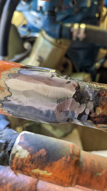

Does anybody know of a no hotwork method of attaching a fitting to a 1" pipe that operates up to 3000 psi? There are numerous products for 1" tube but I'm coming up empty handed for pipe. I have a few lines that keep cracking in the socket weld. I'm assuming they were welded with the pipe bottomed in the fitting.

I believe the cracking is caused by residual stress from welding. It's not common knowledge in the marine industry that socket weld fittings must not be bottomed out prior to welding.
SW is normally prohibited on high cycle service.
I've never liked SW. If you're going to weld it then butt weld it.

I believe your root cause issue is fatigue cracking of the weld. SW fitting are notorious for this when exposed to high cyclic stresses.
But again, for high cycle service threaded joints are usually avoided / not used.
Combined with bottoming out the fitting you're in high failure mode -

Thank you for the detailed response. We're definitely seeing the root cracking described.
The fitting in the picture is an adapter, SW to NPT
It appears the solution is to lay a whole lot of weld bead on it. There are only 6 pipes giving trouble. I believe I can remove them from the vessel to facilitate repair.
If you can remove them then get them butt welded. All you issues go away.
SW fittings are cheap and nasty. IMHO.
For the high fatigue service, may investigate the failure of the cracked welds and to identify for any possible weld defects, piping cleaning issue, improper weld rod material or weld profile, etc., for fabrication correction.

Could be bottoming-out the pipe in the fitting, but I'd bet that it's vibration that is causing the cracking. We have a large hydraulic press for production and typically if we have had a line break or socket weld/threaded joint crack, it's been vibration that caused it. Some lines had their supports modified, others they just switched to hydraulic hose.
