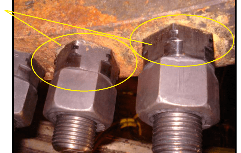

HI, Does anybody has a application criteria about hydraulic tensioner nuts for Shell and tubes HX in terms of Pressure, temperature and fluid nature?
I starting to study of these nuts in order to evaluate a purchase order, I am working at a refinery mechanical design group (Mexico City) ; In the past I heard that an Craker Decoke Licensor stated: " use them for lethal fluid, 400°C @ 70 kg/cm2 operations conditions. Any advice will be appreciate.
Can you tell us the bolt diameter?
Regards
There are several form 7/8" - 1- 1/4" Studs SA-193, Nuts SA-194
Read ASME PCC-1
