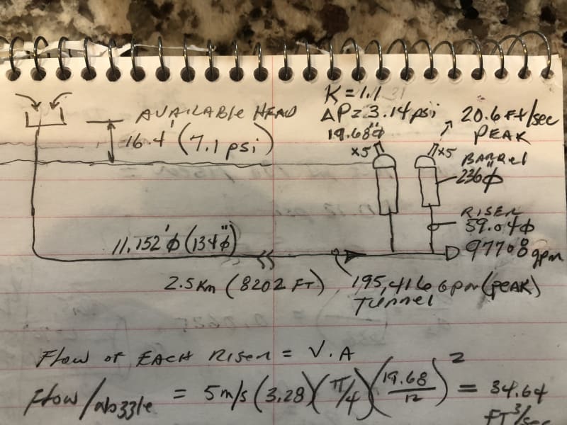

Based on my understanding of how your system is configured here is the results of my calculations. My calculations are based on the following assumptions:
Peak flowrate is 97708 GPM per riser based on your statement that peak flow gives 3.5 m/s in risers.
Specific Gravity of Liquid = 1.0
K factor for nozzles = 1.1
Calculation of pipe pressure drop using darcy equations for new steel pipe.
Inside pipe diameters considered as pipe diameters indicated.
Pressure Drops:
Nozzles = 3.14 psi (assumed K = 1.1 where 0.1 accounts for friction loss and 1.0 accounts for exit velocity head, 19,542 GPM per nozzle)
Inlet to Nozzles = 1.43 psi (based on sudden contraction K = 0.5)
Barrel pressure loss = negligible (at 0.72 fps)
Loss in Riser = 0.19 psi (based on 100 ft length at 11.45 fps)
Loss in Riser Outlet to Barrel = 0.88 psi (based on K = 1.0 at 11.45 fps based on sudden expansion)
Loss in 2.5 km Tunnel/Pipeline = 0.99 psi (at 195,420 GPM)
Total pressure drop = 6.63 psi
As you indicated the only place to reduce pressure drop is inlet to nozzles and outlet of riser to barrels.

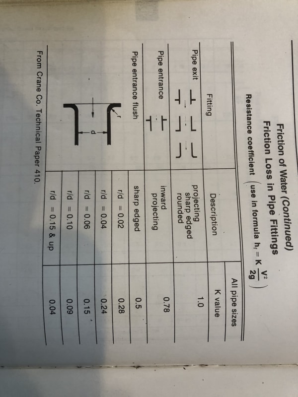

I believe if you change the inlet to the nozzles to a rounded entrance then you can eliminate most of this inlet loss of 1.43 psi. A very rounded inlet gives very low K values. Also if you increase the take off hole diameter to very large and gradually reduce to the nozzle diameter this may also reduce the pressure drop here if it is too difficult to fabricate or procure a rounded inlet.

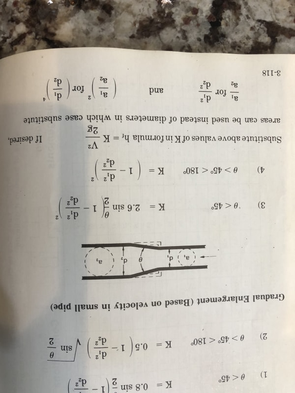

For the outlet of riser to barrels I believe that in any case with a bellmouth or short increaser at exit the ratio of diameters will not change so 1.0 (1-(d1/d2)2) K value does not significantly change by increasing the diameter of the riser with a bellmouth fitting or a single short increaser. Think of it as the exiting velocity will still be basically a jet based on the velocity in the riser, not based on the exist area of the bellmouth (flow will not conform to the increased exit but will still be a jet base on riser diameter), with headloss = 1.0 (V2/2g) of riser so increasing 2x area with bellmouth or short increaser will still give a jet the diameter of the riser that will exist into the barrel causing similar pressure drop as a sudden expansion in my opinion. I believe most to the pressure loss for sudden enlargement is in the dissipation of the kinetic energy of the jet in a disorderly manner inside the larger pipe fluid across the suddden expansion rather than gradually reversibly converting the kinetic energy of the upstream side to pressure head (like is normally done in a increase like in a pipe since that is short yes but diameter change is not large).
I think what you need to do is install a gradual increaser at the connection of the riser to the barrel over a significant distance, maybe a series of increasers so that the flow really goes from a velocity of 11.4 ft/sec to much lower in an orderly manner so that the velocity really is the based on the ratio of areas at exit of riser to the barrel. Note that for a low pressure drop reducer/increaser the angle of the sides of the reducer makes from the smaller diameter to the larger diameter is 45 degrees or less, therefore length of reducer/increaser would be a minimum of 6 feet long if one increaser. I would make it maybe 9 ft long with multiple incresers to be conservative.
Also possibly you can tap into the tunnel and install and additional riser to each barrel if that is possible which would also reduce the velocity at connection by 2 and friction loss by a factor of 4.
Note that if you do not increase nozzle size but flowrate increases significantly then you will be back where you started from with new pressure drop in nozzles being higher to negate the benefit of making any of the other changes you could make to reduce the pressure since the nozzles are where most of your pressure drop occurs.
Here is a sketch of the system that I made based on my understanding of how it was described.
Cameron Hydraulic data for head loss through rounded exit Or any sudden exit is still K=1.0
Head loss through gradual increaser:
