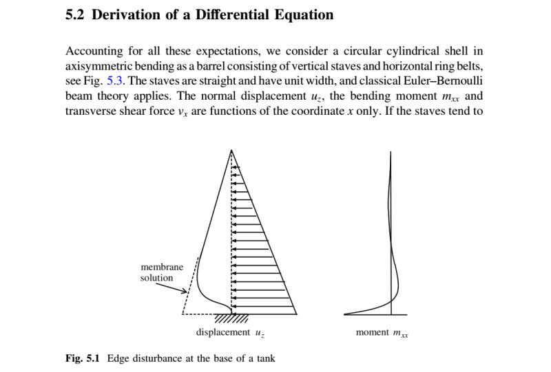

The conn. of shell to bottom always a headache and there is no simple solution. The hoop stress at bottom approaches to zero but the bending moment will reach to maximum.
The following figure from Structural Shell Analysis (by Johan Blaauwendraad,Jeroen H. Hoefakker )
