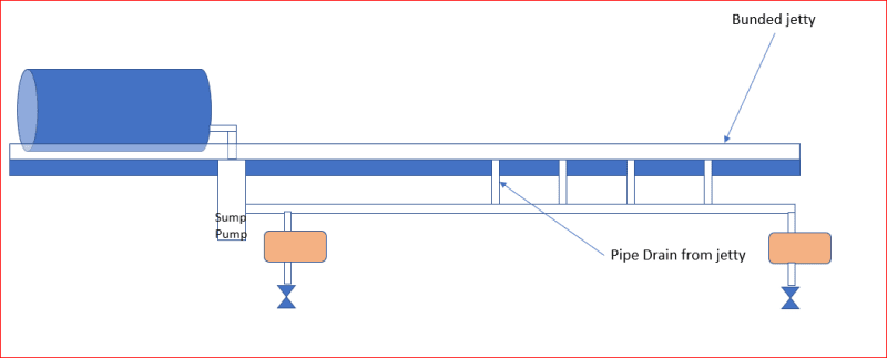

HI LittleInch
I have attached a schematic.
This is a bunded jetty with fuel transfer facilities, so the occasional (seldom & very minor) spill from hoses connection and disconnection.
Potentially small amount of hydrocarbon on the jetty surface.
During rain, rainwater is drained from the bunded jetty via the under jetty pipe and goes to the sump pump. The pump pushed the rainwater to the holding tank.
If water draining to the tank is clear, the valve to the sea might be open, manually.
Tank is drained via a vac truck.
Issue one: Tank could not cope due to heavy rain
Issue two : And/Or no one on night shift to operate the valve.
Issue Three: Minute amount of oil + 99.9% rainwater that goes to the tank (65kL) will be removed by the vac truck to be separated at an external facility. Very expensive exercise (based on the total volume).
Your proposal using Aquaoil forecourt separator seem to be an option. But not sure if the design is suitable for the heavy rainwater flow rate.

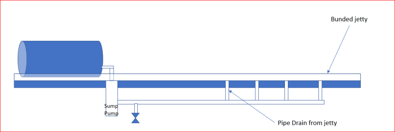

I have attached a 2nd schematic with the separators at both ends. What's your thought?
With the propose Aquaoil forecourt separator
I think you are better off going via the tank to the interceptor so that you have a buffer storage for heavy rain. Plus if there is any large oil spill you have somewhere to store it as the interceptors can get overwhelmed / fill up and pass over a large spill into the drain. The more sophisticated interceptors have level alarms etc which close the outlet valves.
A lot of systems don't have this so people end up having a large separator to deal with high rain flow, but if you have a buffer tank then you can probably have a smaller unit.
You really need to do a design based on good rainfall data including peak rain for 15mins for your catchment area etc to size your system accordingly.
There always need to be some compromise about the heaviest rain and flow capacity of the interceptor, but having your tank helps a lot and if a bit of ponding in the bund is acceptable then max flow is based on your sump pump.
