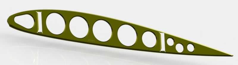

Here's a render of the "standard rib" looks to be about 40 of them for the whole plane. Nose it cut out a good bit. There are 2 spar pass thrus.
(NACA M12 Profile 48" Chord)

A picture is worth 1000 words.
This could be made in a rubber press but not all at once. Better to put in the lightening holes and spar cut-outs after the flanges are formed. But there are warnings of many problems yet to come...
Since 80% of the rib material has been removed by lightening holes, it must be safe to assume that the rib doesn't really have much function in the aircraft, right? ...facetious comments aside, sorry... I believe this part will have significant warping problems no matter how it's manufactured. The lightening holes are so large they compromise the part. All forming processes leave internal stress in the material, and when multiple deformations interact they ALWAYS cause warping. Forming in O condition won't solve this. The rib will need to have these issues addressed.
The spar cut-outs have tiny relief corners but they're inside the bend radius. Cracking is almost guaranteed. Ribs are normally split into separate parts for this reason. (Heck, whether you cut them at manufacturing, or let them crack in flight, either way it makes itself into separate pieces!)

I have to say it's pretty representative of what's on the print. First draft was 4/18/1929 They didn't know about cracking back then lol. There is an STC that replaces a good number of these with plywood because of cracking. especially over the fuel tank.
Its 2 wooden spars, these are wood screwed (AN 545-5-4) to the spars with a wood drag strut out at the interplane struts. These "ribs" are more less formers for the fabric. I wish I was comfortable enough to try something different. I hate the design. I really do. But I've flown on them and they work. It was the longest running aircraft without a structural AD until they started trying to build them again about 10 years ago. I would LOVE to have composite wings for this but that's something I know less about than hitting metal into shape.
that may be the shape they ended up with … but do you Know it was made in one step, or possibly multiple steps like SW is suggesting ? Possibly they did it in one step and accepted a high scrap rate as the cost of doing business (not knowing any better) ?
what's happening at the acute angle at the T/E ? two separate flanges, or one (wrapping around the corner ??
forming the skin flange, then stamping the lightening holes then the spar penetrations sounds like a reasonable plan to me. If you cut the lightening holes first I can see that they may deform as you form the flange.

They certainly intend on it being done in a few steps.
The instruction pack for the prints say to use tooling pins where the lightning holes get knocked out. I've got a short list of CNC routers I hope to pull the trigger on before too much longer. Planning to use it to cut blanks... probably would make short work of cutting out the lightning holes and the spar flanges after the -W wears off. I have a few lightning hole punches that punch and flange in one hit that also happily form -T3.

The Verson Wheelon press is fast enough to form 2024 in the W temper, keep the parts in a container with dry ice until you are ready to throw them in the press. If you have more than one forming die like a left and right hand that bed is big enough to do several at once.
If you cut the blanks on a CNC router allow at least an extra 3/16" on the flange to allow for "drag in" when the when the raised flanges form on the lightening holes. You can also do your flange trimming with the CNC router if you clamp the parts down well to the table. Use a star cutter, or take several goes with a single flute up cut router bit, a wooden sacrificial backer behind the flange helps to keep the vibration down. When you cut the lightening holes leave tooling tabs on some of your holes, so your part does not skitter over the table on the last couple of holes. Good luck with this. By the way, are you prepared to share the aircraft make and model?
