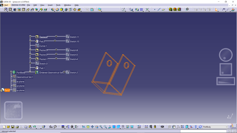

Hi guy happy new year!
When I open any catia Part, it only shows lines of the dessing when I pass the mouse over them.
can someone help me please?
Click the little axis in the lower-right corner of the screen - this will make the graphics active, instead of the spec tree.
I also see several other things (based on settings) that I don't like to use (neither do most users). But since you haven't complained, I'll let you continue.
Hi Jack thanks, I just did that and it kind of works, cause it doesn´t show me the pad, just the lines of my product, and I would appreciate if you could tell me what other things you don´t like to use, or how can I restore my settings, so they be as the same way as yours.

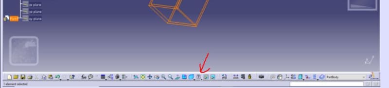

Hi Cesar ,
Check Shading with Edges in View toolbar :
maybe that one works.
