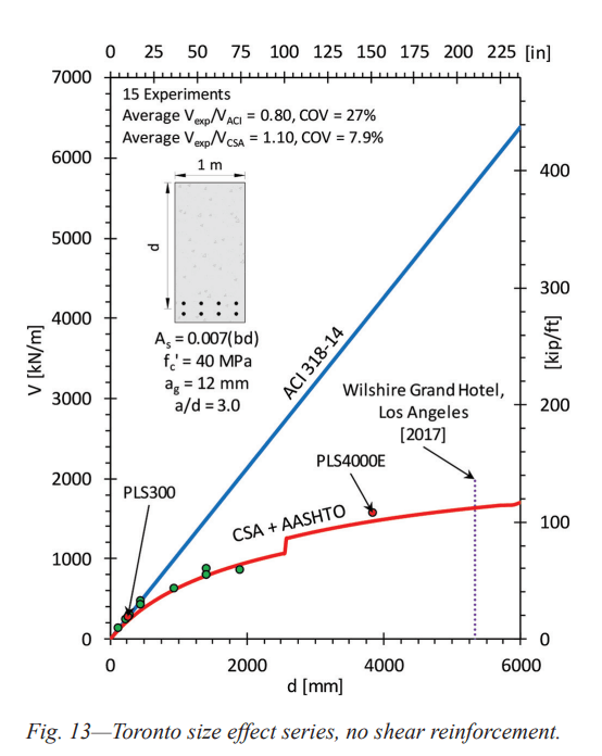

I see this more and more, especially taller walls. I suspect it comes from MCFT forming the basis of more design codes these days, where thicker elements are penalised to an extent when it comes to shear strength. In many cases, thickening the stem only gives you a modest increase in shear strength. Adding even the minimum shear reinforcement will add a whole heap of shear strength and is not necessarily difficult to install.

You guys are seeing this more because I think ACI got around to putting the size effect stuff into the code. We've had it in Canada for a bit longer and even then there's still some feeling out about when it makes sense to thicken vs reinforce. It very quickly starts getting into diminishing returns once you're in the 18-24inch range. That being said, 7% isn't a lot.
There's a good paper here that has a bunch of test results and other information on the concept:
This graph is the real meat of it, though.
